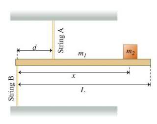

A Bar Suspended by Two Vertical Strings
  • Thread starter Thread starter laxmanic33
    Strings Vertical
2 replies · 39K views · last reply
laxmanic33
A rigid uniform horizontal bar of mass m1 = 85.00 kg and length L = 5.300 m is supported by two vertical massless strings. String A is attached at a distance d = 1.500 m from the left end of the bar and is connected to the top plate. String B is attached to the left end of the bar and is connected to the floor. An object of mass m2 = 2000 kg is supported by the crane at a distance x = 5.100 m from the left end of the bar.
Throughout this problem, positive torque is counterclockwise. Use 9.81 m/s^2 for the magnitude of the acceleration due to gravity.
(1) Find T(A) the tension in string A.
(2) Find T(B) the magnitude of the tension in string B.
Ta = (Torque due to weight of bar + Torque due to weight of object) / (l/2)
Tb = Ta*d - m1g(L/2) - m2gx
I got Ta = 68111.63, It says that I am close, rounding error, and it has to be in 4 sig figs.
I got Tb = 34056.45, and no dice with this one.
I don't understand how you arrived at these equations.
To find Ta, set up a torque equation about the point where string B connects to the bar; To find Tb, set up a torque equation about the point where string A connects to the bar.
Are you using T for both torque and tension? Some units would be a big help to you.
