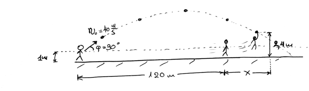

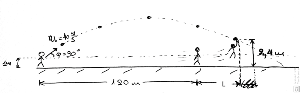

Α baseball player throws the ball and another player 120 meters far, starts running...
nil

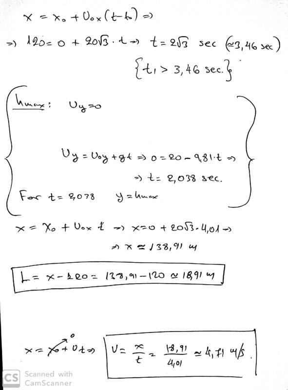

Hi all !

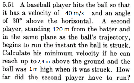

I wonder if I'm right.
(From : Fundamental University Physics, Volume 1 (Mechanics) - (Marcelo Alonso, Edward J.finn) Addison Wesley 1967)
This is my try:
* I have the Greek version of the book and there is no answer.Thanks.
Edit:
Looks good to me.
Me too!
