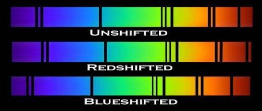

Hey everyone,
I get it - the faster the object is moving away from me, the more the light it emits moves to the red side of the spectrum.
But here's my question:
Here on earth, we watch galaxy A, which seems to have a very red light. How can we know it's not "originally" that red, and if it hadn't moved at all, it would've been a bit bluer? Where's that information embedded?
As an example, if I sent you a sample of a man talking with an extremely low voice, you wouldn't be able to say it's "originally" medium-pitched, and the reason it's low now is because the man has been moving away from me while recording?
Thanks.
Space news on Phys.org
You would have to know the usual pitch of the man's voice. Luckily, we do know in the case of redshifting galaxies, since we can look at different spectral lines and identify where they belong.
In the spectral lines! See the image below. The top spectrum is a spectrum showing absorption lines. These lines correspond to a specific element and only that specific element. As the spectrum is redshifted from either relative motion or expansion, the lines move towards the red end but, crucially, keep their exact same pattern. By studying the redshifted spectrum and comparing the lines to where they are in the unshifted spectrum we can identify how much the redshift is and from there figure out the recession velocity of the galaxy.
Image from here: http://coolcosmos.ipac.caltech.edu/cosmic_classroom/cosmic_reference/redshift.html
