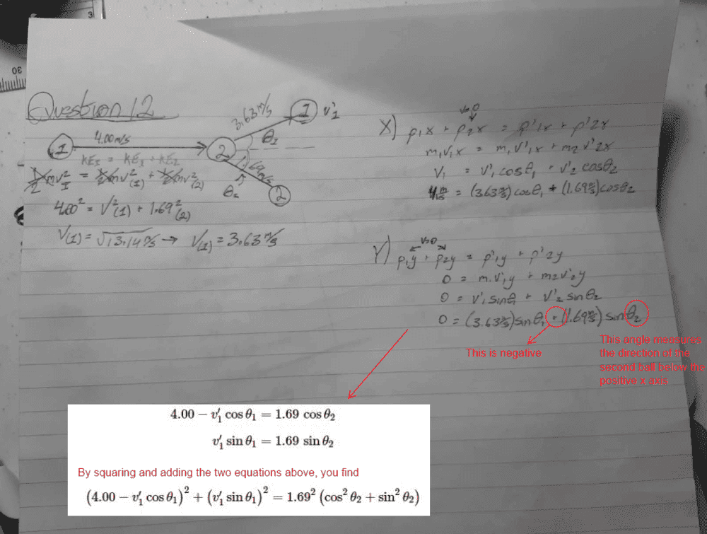

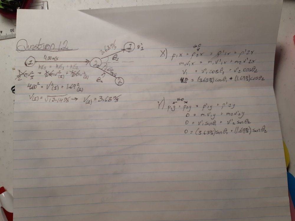

A billiard ball moves at a speed of 4.00m/s and collides elastically with an identical stationary ball. As a result, the stationary ball flies away at a speed of 1.69m/s, as shown in Figure A2.12. Determine the final speed and direction of the incoming ball after the collision and the direction of the stationary ball after the collision
KEi = KE1 + KE2
p1x + p2x = p'1x + p'2x
p1y + p2y = p'1y + p'2y
cos(theta1)^2 + sin(theta1)^2 = cos(theta2)^2 + sin(theta2)^2
I know this question has been asked before but I really need some help finishing this final piece of the puzzle.. I have attached an image of my work to show how far I have gotten towards the solution but my unfamiliarity with trigonometry equations has gotten my stuck. Please assist! thank you

ejantz said:
Problem Statement: A billiard ball moves at a speed of 4.00m/s and collides elastically with an identical stationary ball. As a result, the stationary ball flies away at a speed of 1.69m/s, as shown in Figure A2.12. Determine the final speed and direction of the incoming ball after the collision and the direction of the stationary ball after the collision
Relevant Equations: KEi = KE1 + KE2
Remember, ##\sin^2(\theta) + \cos^2(\theta) = 1 ## for any angle.

okay perfect, yes. so next step:
(4 - v'1 cosθ1)^2 + (v'1 sinθ1)^2 = 1.69^2 (cos^2 θ2 + sin^2 θ2)
this second part would be: = 2.8561 X 1 = 2.8561
but the first half now I am still struggling.. should i substitute in the v'1 (3.63) value?
(4^2 - 3.63^2 X cos^2 θ1) + (3.63^2 X sin^2 θ1) = 2.8561
2.8231 X cos^2 θ1 + 13.1769 X sin^2 θ1 = 2.8561
2.8231 X cos^2 θ1 = 2.8561 - 13.1769 X sin^2 θ1
2.8231 X cos^2 θ1 = -10.32 X sin^2 θ1
(2.82 / -10.32) = (sin^2 θ1 / cos^2 θ1)
-0.2735 = tan θ1
θ1 = tan-1(-0.2735) = -15.3
θ1 + θ2 = 90
θ2 = 90 - (-15.3)
θ2 = 105.3
I know I went wrong somewhere.. thank you for your help!
##(4 - v'1 \cosθ1)^2 ## is not equal to ##(4^2 - 3.63^2 \cos^2 θ1)##
How do you get the square of (a-b)?
