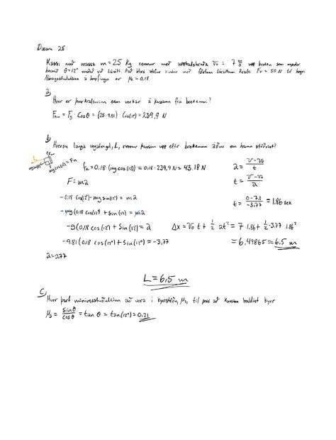

A box with the mass m = 25 kg is sliding with starting speed of V0=7m/s up a hill that has the angle Θ=12°. there is a steady wind blowing with a horizontal force of Fv = 50N. The coefficient of friction is µk = 0.18.
a) What is the force that works on the box from the hill?
b) What distance, L, does the box slide up the hill before it stops?
c) What does the coefficient of friction need to be at the lowest so the box doesn´t slide back down the hill*
What I have already attempted is on my Ipad and I don't know how to upload it on here.
With hope of help
DJ
This is what I did. What do you guys think?
Here is a pdf probably better to view that
##6.5m## looks like the distance without the wind blowing.
ah that's right i forgot to add that in thank you so much :)
  • Sad
Same for part c). ##\mu = \tan \theta ## is the calculation without the wind.
Same for part a.

I'm not quite sure how to work the wind into the equation. Any hints for it?
It's a force like any other.
See post #5.
Danielheidarr said:
This is too hard to read. The subscripts are illegible and the thumbnail sketch FBD far too small. Draw decently sized diagrams and type equations.
Don't forget the wind force has a component normal to the slope.
