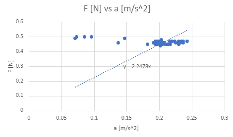

I am trying to verify Newton II. The setup I am using is,
Where ##m_1 = 0.887 kg## is a cart and ##m_2 = 0.02016 kg## is a small hanging mass. There is a force sensor on ##m_1## to measure the force acting on it from the string and the acceleration of the cart.
To verify Newton's Second Law, we tried to plot we plot acceleration of ##m_2## vs force ##F## which is the same as the tension ##T##.
Apply Newton II to the ##m_2##: ##T = m_2a + m_2g## which is a linear equation (##y = mx + c##) of the form,
which is of the form ##y = T, m = m_2, x = a## and ##c = m_2g##
Therefore we graphed T vs a to get:
However, do you please know why I am getting ##m_2 = -0.2152 kg## from the graph when we measure it to be 0.02kg? I am not sure why the negative sign and why it is x10 larger than the measured ##m_2##. Also when I solve ##c = 0.5069 = m_2g##, for ##m_2## I also get a very different value for ##m_2##
Any help greatly appreciated!
Many thanks!

To verify Newton's Second Law, we tried to plot we plot acceleration of m2 vs force F which is the same as the tension T.
Well, no, the F in Newton II is the net force. There are two forces acting on m2.

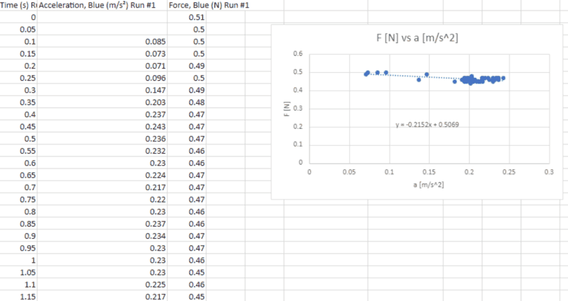

The first thing to be clear about is your sign conventions. Which way are you taking as positive for a? Does T act on m2 in that direction? What about m1?
I don’t understand what you are plotting here. The leftmost column is timestamps in increments of 1/20s, Implying these are measurements in a single drop. These should hardly vary. The only reason they do is some inaccuracy in the readings near the start. The slope of the graph you plotted is of no interest here.
You note that ##T = m_2a + m_2g## is a linear relationship, but if you want the slope to represent the mass you must get it in the form ##y=m_2x+c##.

For ##m_2##, I am taking upwards as positive and downwards as negative so if ##T < m_2g## then ##a < 0##.
Yeah the measurements are in a single drop. Sorry, how is the slope of the graph of no interest?
Getting that linear relationship for ##T## in ##y = mx + c## form we get ##T = (m_2)(a + g)##.
I decided to plot the graph again and set the y-intercept equal to zero since ##T = (m_2)(a + g)## is in ##y = mx## form to get the graph:
This is closer to the original value for ##m_2##, however, why is ##m_2## so large from the graph?
Many thanks!
Do you really that linear fit describes your data?
Thank you for your reply @malawi_glenn !
Yes I do. I don't have any reason to not think that the linear fit is for the data.
Many thanks!
What is the R-squared value?
Thank you for your reply @malawi_glenn ! The value is 0.95 (2 sig figs).

But in your table you have written positive values for acceleration, so did m2 accelerate upwards? If so, I guess the mass must be negative.😳
since T=(m2)(a+g) is in y=mx form
Yes, but you plotted against a. What is x according to what you wrote above?
As I wrote in post #22, in a single drop all the values should be the same: all the forces should be the same and all the accelerations should be the same. Your data have the acceleration increasing at first. To explain that, there must be some systematic error in the early readings. I would ignore all the data before it settles down to a fairly constant acceleration. The slope you found merely tracks how the error evolves during the drop.
1. Discard the dodgy data,
2. Take the average T and average a of what remains,
3. Correct the sign error in T=(m2)(a+g), and
4. … use that to find the mass, not T=(m2)a.

You can eliminate ##T## from these two equations, to get ##\displaystyle \quad a=\dfrac{m_2}{m_1+m_2}\,g ##.
For the values that you have, this gives an acceleration of approximately ##0.22\,\rm{m/s^2 }## . This agrees fairly well with your data.
However, this gives a value for the tension of approximately ##0.19\,\rm N ##.
This is problematic.
Likes ChiralSuperfields and erobz
  • #35
The tension in the string cannot be more than the weight of m2, which is round about 0.2 N. Something is wrong with your measurements.
