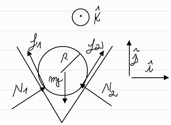

A cylinder of mass m and radius ##R## is rotating in a V-shaped groove with a constant angular velocity ##\omega_0##. The coefficient of friction between the cylinder and the surface is ##\mu##.
What external torque must be applied to the cylinder to keep it rotating at a constant angular velocity? Express your answer using some or all of the following variables: ##m## for the mass of the cylinder, ##g## for the gravitational acceleration, ##R## for the radius of the cylinder and ##\mu## for the coefficient of friction.
##\vec{\tau}=\vec{r}\times\vec{F}##
I am confused because according to my solution the disk is already rotating at constant angular velocity.
I have written the translational equilibrium on the horizontal and vertical component:
##N_1## and ##f_2## will have a positive horizontal contribution, while ##N_2## and ##f_1## will have a negative contribution:
$$\frac{1}{\sqrt{2}}N_1-\frac{1}{\sqrt{2}}N_2+\frac{1}{\sqrt{2}}\mu N_2 - \frac{1}{\sqrt{2}}\mu N_1=0$$
$$\Rightarrow N_1=N_2=N$$
All of the forces except gravity will have a positive vertical contribution:
$$\frac{1}{\sqrt{2}}N_1+\frac{1}{\sqrt{2}}N_2+\frac{1}{\sqrt{2}}\mu N_1+\frac{1}{\sqrt{2}}\mu N_2-mg=0$$
$$\Rightarrow N=\frac{1}{(1+\mu)\sqrt{2}}mg$$
The current torque will only come from ##f_1## and ##f_2##:
$$\vec{\tau}=R\mu N_2\hat{k}-R\mu N_1\hat{k}$$
... which simplifies because ##N_1=N_2## !
What am I doing wrong?
Nevermind, ##f_2## is acting in the opposite direction.

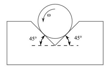

You have assumed the groove is a right angle. The question statement you posted does not specify.
It actually is!
This is their drawing, but they did not specify in the problem.
By the way, I have got ##\vec{\tau^\text{ext}}=\frac{2\mu^2}{2+\mu^2}mgR\sqrt{2}\hat{k}##
Hope it's good!

You should try to check answers by considering special cases.
If ##\mu=1##, one of the normal forces goes to zero, the friction on the other slope being sufficient. It's easy to what the torque would be in that case, and it is not ##\frac{2\sqrt 2}3mgR##.
if you can't find your error, please post your working.
I got these relations from the translational equilibrium:
$$\frac{N_1}{N_2}=\frac{1+\mu}{1-\mu}$$
$$(1+\mu)N_1+(1-\mu)N_2=mg\sqrt{2}$$
Solving for ##N_1,N_2##:
$$N_1=\frac{1+\mu}{2+\mu^2}mg\sqrt{2}$$
$$N_2=\frac{1-\mu}{2+\mu^2}mg\sqrt{2}$$
Torque from frictions:
$$\vec{\tau_{f_1}}=-R(\mu N_1)\hat{k}$$
$$\vec{\tau_{f_2}}=-R(\mu N_2)\hat{k}$$
Total torque from frictions:
$$\vec{\tau_f}=-\frac{2\mu}{2+\mu^2}mgR\sqrt{2}\hat{k}$$
Still not good...
@haruspex Solved it. If ##\mu=1## the additional torque needed is
$$\vec{\tau^\text{ext}}=\frac{1}{\sqrt{2}}mgR$$.
In general
$$\vec{\tau^\text{ext}}=\frac{\mu}{1+\mu^2}mgR\sqrt{2}$$
... which respects the particular situation of ##\mu=1##.

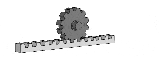

If you can imagine the assembly as a rack-pinion mechanism, you could visualize the pinion climbing up one side of the V grove and separating itself from the other.
Lnewqban said:
Welcome, @Justforthisquestion1 !
Post #5 may contain the answer to your question.
Right! Normaly the cylinder would climb up the side! And to counterbalance that the normal force on this side needs to be larger! Thank you both!
