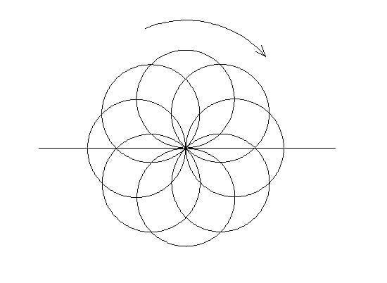

After reading it, wouldn't that mean that the equation definitely wouldn't work? Since if the axis of rotation was indeed the point of contact, that would mean that there is no translational motion at all. So it would just be:
##KE_{total} = \frac {1} {2} I \omega^2## where ##I## is the moment of inertia about the ground/point of contact.

That is true only instantaneously.
Otherwise, we will have a cylinder constantly rotating about the contact point, and its center the mass will describe a circle of radius similar to the radius of the cylinder.
I do see that it is rotating, but since the axis of rotation is changing every moment it is as if it were moving translationally. But if it has only rotational kinetic energy instantaneously for every instant, wouldn't that mean that it only has rotational kinetic energy for the entirety of its roll?
You can pick an axis and factor the motion of a rigid object into translation of that axis plus rotation about that axis in many ways. There is no one "fact of the matter" on where the energy "really" is or what the axis of rotation "really" is.
But yes, you can do an energy accounting considering that the entirety of the kinetic energy of a rolling tire is always manifested in rotation about the momentary position of the contact patch if you like.
There is no rotation about the center of mass of the cylinder only.
Even in the case of the last post, the CM, as well as other points, are describing a circle.
The rotational inertia to overcome in that case should still be greater than the rotational inertia of the cylinder about its axle.
Please, see:
http://hyperphysics.phy-astr.gsu.edu/hbase/parax.html#pax
Pure translation (skidding cylinder on frictionless horizontal surface) requires certain amount of translational kinetic energy.
Translational work = FS = maS
Pure translation (cylinder rotating around frictionless static axle) requires certain amount of rotational kinetic energy.
Rotational work = τθ = Iαθ
A combined movement requires both, which should be added up.

I'm still confused about the idea that there is no rotation about the center of mass. If there was no rotation about the center of mass, wouldn't there be no translational kinetic energy? But it wouldn't move in a circle like in post #11 since the axis of rotation is constantly shifting.
