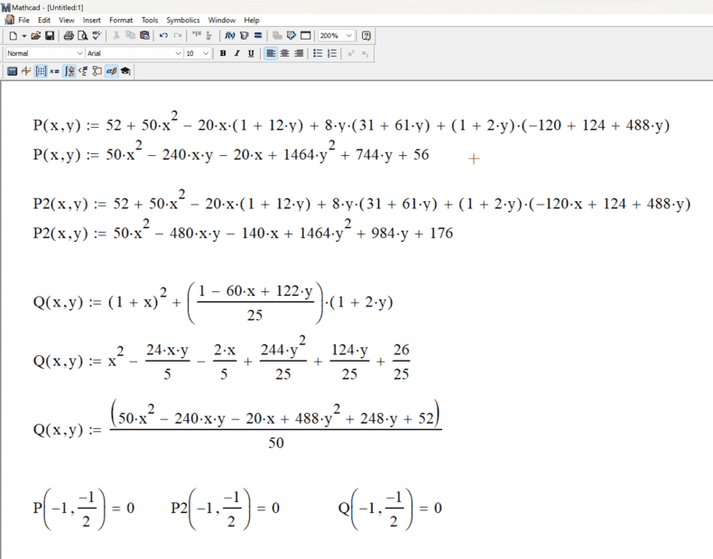

I just realised this appears to be wrong.
The coefficient of ##x^2## in the first expression is 50, while in the second it is 1. So the two polynomials cannot be the same.
##q=(-1, -0.5)## is a double root of the second polynomial in the sense described by @mathwonk, but not of the first polynomial.
It looks like we should forget about the first polynomial and focus on the second.
Regarding @mathwonk's simpler example ##x^2+y^2=0##. I note that factorises to ##(x-iy)(x+iy)=0## whose solution is all points of form ##(c, ic)## and ##(c, -ic)## for complex ##c##. Taking ##c=0## gives us our only real root, and it's a double root because it is the intersection of the ##(c, ic)## and ##(c, -ic)## branches.
Maybe Wolfram can factorise the second poly in the OP, if anybody wants to type it in.
ok, i'm not sure about this, but as andrewkirk said, it seems the original polynomial was written wrong, and perhaps the last parenthesis should contain (-120x + 124 + 488y), i.e. an "x" was apparently omitted after -120. at least this seems to make the polynomial have a double root at (-1,-1/2). moreover it is possible that then the original polynomial, after this modification, equals 50 times the second one, accounting for the different x^2 coefficients, but I have not checked that.

My computer doesn't agree. Although I suppose that doesn't change the basic question about multiplicity of roots in multi-dimensions.
mathwonk said:
it is possible that then the original polynomial equals 50 times the second one, accounting for the different x^2 coefficients, but I have not checked that.
It's a mess, none of them agree, except for the root at (-1,-1/2). I find it annoying when polynomials aren't presented in a standard form. Maybe the weird format makes sense to the OP, but I don't understand why.
I plugged the second polynomial ( Q(x,y) in the notation introduced by @DaveE ) into Wolfram here.
That gave the factorisation as:
$$Q(x,y) = \frac1{25} (5 x - (12 + 10 i) y - (1 + 5 i)) (5 x - (12 - 10 i) y - (1 - 5 i))$$
So ##y = (5x - 1 - 5i) / (12 + 10 i)## and ##y = (5x - 1 + 5i) / (12 - 10 i)## are the two branches of the solution.
Putting x = -1 gives y = -1/2 for both branches. So the point (-1, -1/2) is a double root because it occurs in both branches.
Further it is the only double root because a double root must satisfy the equations of both branches and, since they are two linear equations in two variables, they can have at most one solution.
