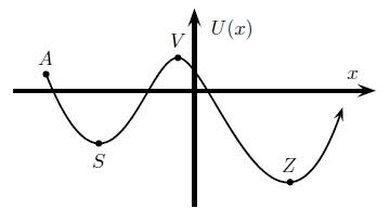

1.)A particle is released from point A and
moves in the potential U(x). Suppose the
mechanical energy of the system is conserved.
At which position(s) will the kinetic energy
of the particle have its maximum value?

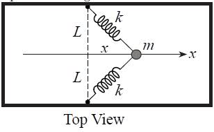

5.)A particle of mass 8.95 kg is attached to two
identical springs on a horizontal frictionless
tabletop as shown.
The springs have spring constant 37.7 N/m
and equilibrium length L = 0.74 m.
If the mass is pulled 0.428 m to the right
and then released, what is its speed when it
reaches the equilibrium point x = 0?
Answer in units of m/s.

1.) I guess I don't really understand what to look for in this graph, I know that for a negative slope the force is positive and S and Z are neutral equilibriums and V is an unstable equilibrium. I was not sure how to determine the maxiumu KE though..

5.) I honestly just don't know what to do for this one >.<Help on any of these problems would be greatly appreciated I got to all the lectures and read the book, but unfortunately I seem to be failing when it comes to applying things. I know these are a lot of questions but help would be appreciated!
for #1, if U(x) is potential energy and all energy is conserved, what happens if potential energy decreases? What place can it only transfer, i.e. what increases when potential energy decreases?
