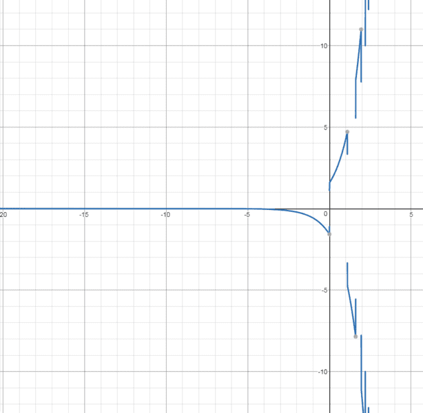

The function I found is
##\frac{-\pi e^x\cos \left(\frac{\pi e^x}{2}\right)}{2\sqrt{1-\sin ^2\left(\frac{\pi e^x}{2}\right)}}##
If you tell WolframAlpha to solve for this function equaling it's derivative it outputs the result "True" (you need to leave the page to load for a few seconds though). Here's a link to it: https://www.wolframalpha.com/input/...os((e^x+π)/2))/(2+sqrt(1+-+sin^2((e^x+π)/2)))
At first I thought this may be a big deal until I simplified the function and found that it actually has a general form of ##f\left(x\right)=e^x\cdot \frac{h\left(x\right)}{\left|h\left(x\right)\right|}##. So basically I discovered that:
If: ##f\left(x\right)=e^x\cdot \frac{h\left(x\right)}{\left|h\left(x\right)\right|}##
Then: ##f'\left(x\right)=e^x\cdot \frac{h\left(x\right)}{\left|h\left(x\right)\right|}##
I'm not sure if this is of any significance or not.

##\frac{\cos(\pi/2 \cdot e^x)}{\sqrt{1 - \sin^2(\pi/2 \cdot e^x)}}## is just a complicated way of writing 1, so your function f(x) is essentially a constant (##-\frac \pi 2##) times ##e^x##.
##\frac{\cos \left(\frac{\pi }{2}e^x\right)}{\sqrt{1-\sin ^2\left(\frac{\pi }{2}e^x\right)}}## is only equal to 1 when ##\cos \left(\frac{\pi }{2}e^x\right)>0##. When ##\cos \left(\frac{\pi }{2}e^x\right)<0## it equals -1. Referring back to ##\frac{-\pi e^x\cos \left(\frac{\pi }{2}e^x\right)}{2\sqrt{1-\sin ^2\left(\frac{\pi }{2}e^x\right)}}##, the graph generated from this has values which alternate between being positive and negative depending on whether the solution is positive or negative. This is what it looks like graphically:
[tex]f\left(x\right)=\frac{-\pi e^x\cos \left(\frac{\pi }{2}e^x\right)}{2\sqrt{1-\sin ^2\left(\frac{\pi }{2}e^x\right)}}[/tex]
Differentiating
$$f(x) = e^x\frac{h(x)}{|h(x)|}$$
by the chain rule gives
$$f'(x) = e^x\frac{h(x)}{|h(x)|}+ e^x\frac{d}{dx}\left(\frac{h(x)}{|h(x)|}\right)$$
But the function
$$\frac{h(x)}{|h(x)|}$$
simply gives the sign of ##h(x)## at ##x##. This is a constant in the areas where ##h(x)\neq 0##, so its derivative ##dh/dx## is equal to zero in those areas. Where ##h=0##, the derivative is undefined.
TeethWhitener said:
Differentiating
But the function
Exactly, this means that ##e^x\cdot \frac{d}{dx}\left(\frac{h\left(x\right)}{\left|h\left(x\right)\right|}\right)=0## for all values of ##x## except for ##h(x)=0##.
Therefore ##f'\left(x\right)=e^x\cdot \frac{h\left(x\right)}{\left|h\left(x\right)\right|},\ h(x)\neq0## which is same as the original function ##f(x)##.
Right. ##h(x)/|h(x)|## is piecewise constant, so if we multiply it by any function ##f(x)##:
$$g(x) = f(x)\frac{h(x)}{|h(x)|}$$
and differentiate, we get:
$$g'(x) = f'(x)\frac{h(x)}{|h(x)|}$$
where ##h(x) \neq 0##, and the derivative is undefined where ##h(x) = 0##.
