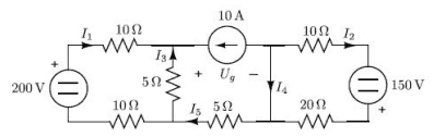

In the circuit of the figure, determine the intensities I1, I2, I3, I4, I5 and the voltage Ug.
Superposition and Kirchoff
20-10I1+5I3-10I1=0
5I3+Ug+5I5=0
20I2+10I2-150=0
From the last equation, 30I2 = 150, I2 = 5 A
KNOTS:
-10-I4-5=0 I4=-15 A
-I5+(-15)+5=0 I5=-10 A
System of knot equations of I3 and I5 does not work
-10-I1-I3=0
I3+I1-10=0
I3=-10-I1
-10-I1+I1-10=0 -20≠0
Here I have stayed, the part of the left is what resists me

Here it is:
  • Circuit schematic with a 200 V source and 10 Ω resistor in the left branch, a 10 A current source with a 5 Ω resistor and a 5 Ω resistor below, 10 Ω and 20 Ω resistors on the right with a 150 V source, and labeled currents I1, I2, I3, I4, I5 and voltage Ug.

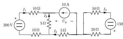

Have you considered rearranging the right hand side of the circuit temporarily?
  • Circuit schematic with a 200 V source and 10 Ω resistor on the left branch carrying I1, a 5 Ω resistor with I3, a 10 A current source with Ug, a 5 Ω resistor carrying I5, and on the right a 10 Ω resistor carrying I2, a 150 V source and a 20 Ω resistor.
