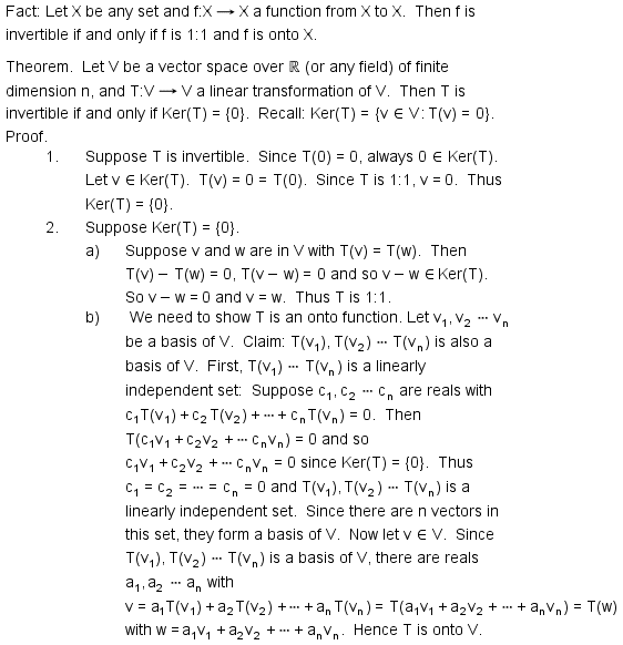

Here's an entirely similar statement and proof. Note the format of the proof of the "if and only if" statement. You need to prove two things, in the following 1 and 2. Now you have a go at your problem.

For the converse, assume the set of Tv's form a basis. Prove if v is in Ker(T), v = 0. Hint: let v be in Ker(T). Then there are c's with
$$ v=c_1v_1+c_2v_2+\cdots+c_nv_n$$
Now prove each $$c_i=0$$
By the theorem in my previous post, T is then invertible.
