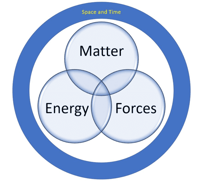

Hi there I am a high school science teacher and I want to present my senior classes with a model of the fundamentals of the physical world to serve as a mind map for us when we reach each topic.
I have started by creating the one below and then realized I may have left off momentum...is momentum worth mentioning as a separate bubble, or just a "mix" of matter and energy? I would really appreciate any opinions. Thanks
This sort of grouping of ideas is very personal and you may well find it useful for yourself.
However, you may need to consider the sort of group you are teaching. Students can be very literal and spend a lot of time worrying about how to apply any such classification system to specific topics and quantities. "Where does this fit in Sir?" could be a frequent question to expect so you'd need to be ready with answers. :wink:
The Hyperphysics site uses such concept maps and you might find their ready made versions useful - (although yours is one layer higher). This maps are very handy as a practical way of checking that the content of a course has been dealt with or for a revision programme. It could be better than just a straight list.
Thank you so much Sophiecentaur.
The reason I have gone up another level from the hyperphysics is that I like to teach by including a single "anchor", using "the power of one" as I call it..ie just one mind map (preferable with symbols that show relationships) page that we can always come back to as a class and orientate ourselves as to where we are up to, and what we have covered in our understanding of physics.
I also like to try and portray a simplicity to the whole subject of physics that reassures the students that the understanding is eventually possible, it just needs to be broken down into its bits, which is where each of the following lessons fits in.Otherwise I find some students see physics as very complicated confusing and daunting.
My concern was that this diagram may had a glaring error with something vital left out eg momentum, that would hamper their understanding further down the track, or some relationship between the concepts that was obviously wrong.
I am going to try and teach the topic by presenting matter, energy and forces as types of "purities" first and look at their definitions, history of understanding and models we now have of each of them. I then intend to go to the textbook and start with the mechanics, thermodynamics chapters etc where we will meet each of these purities and their interactions with each other. I will then ask the students to map out where each of the textbook topics sits on the mind map and place the relevant equations for the topic onto the mind map as we go, just to give them a framework to the whole course.
Any feedback is welcome, thanks.
This is a very good reason not to teach this invention of yours. Also, what about torque?
Adopting this kind of invention is bound to cause more confusion than clarity.
Thanks Vanadium.
I would consider torque to be a type of force...just rotational
pkc111 said:
Thanks Vanadium.
And so it goes on, I'm afraid. You can expect to be flooded with more of that sort of query from students who will take every opportunity 1. to be confused and 2. to challenge you (I have been there).
Looking at your diagram, I see it is a sort of hybrid Venn diagram with no apparent intersection of space / time with the other fields. That implies there is some 'exclusion' involved, which could cause further aggro.
To sum it up, I would say that your idea is too abstract for students whose preoccupations are with learning concrete facts for exams. The diagram will surely be taken as literally as the equations of motion that you write on the board and you could then have to pick up the pieces. Physics is not Philosophy.
And that's why I don't like this. Torque is not a "type of force" - it has different units. Yes, there are some analogs, but ultimately you are forcing yourself to teach wrong things to shoehorn conventional physics into this personal invention of yours.
The only thing I would pick upon is the relegation of momentum to being just a " ... mix of matter and energy... ", which it is not. This is extremely apparent when you do collision problems, where in the majority of cases, momentum is conserved but kinetic energy is not. So how can one be a mix of the other when they obviously follow different conservation laws?
In fact, at a more fundamental level, momentum and energy conservations are due to different symmetry rules of our universe. So they are definitely not of the same specie.
At the level that it is aimed for, I would rather stick with the "subject" categories made by Hyperphysics, with the caveat that these subjects are all interconnected, not separate i.e. a force is a force - of course, of course - no matter whether it is due to a spring, a charge particle, gravity, etc...

you can see problems arising really quickly with this sort of diagram. Consider a student asking " ok - if there is force and matter - what is a force if there is no matter?" the diagram suggests this. the diagram suggests also there is matter without energy. I know YOU may know the specifics related to these kinds of questions, but a student may not even bother asking this but just use it to internalize their own misconceptions, or worse - reinforce them.
Perhaps you would consider treating it more as a tree - in which you can treat the entire course as a build up of ideas from some core questions? I'm only spit-balling here, as i really am not certain of whether this approach is a good idea anyway - i personally find issues with the hyperphysics set up as well, which is useful to a point but suggests linear arrangements of ideas that may not really or should be set up that way.

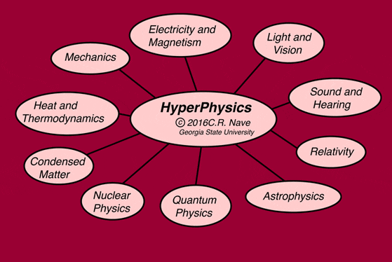

Hpyerphysics already has a pretty good starting diagram, with details down in the diagram (clickable). Why not just start with something more standard like this? Plus, you could use Hyperphysics as an online teaching resource for your class...
http://hyperphysics.phy-astr.gsu.edu/hbase/hframe.html
What about space, time, mass, matter, fundamental interactions and symmetries? Almost everything else comes from these.

pkc111 said:
Where would momentum be? (yes its not really on the intersection of mass and energy)
But your diagram doesn't have mass, it has matter. They are two very different things. The former is yet another one of those human inventions created in an attempt to understand matter. It was thought that mass is a measure of the amount of matter, but the Einstein mass-energy equivalence showed us that that is wrong.

The hyperphysics site is a more correct mind map. As far as I can tell, yours is not even a mind map, maybe closer to a Venn diagram.
I am not sure that I understand your intention here. What is it that you intend this diagram to convey, and how do you intend that students would use it?
