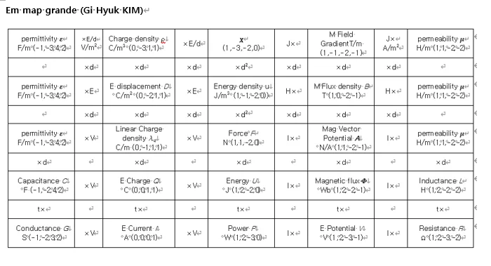

Seeking a named physical quantity with dimension [ML⁻³T⁻²].
Two independent paths from Maxwell's equations (ρ²/ε₀ and μ₀J²)
both yield this dimension, suggesting it may be the apex of an
electromagnetic dimensional hierarchy. Is this quantity known in
established physics?
Background.
I have been building a systematic dimensional map of electromagnetic quantities, organized by their MLTIQNJ exponents. The map places mechanical quantities along a central vertical axis, with electric quantities to the left and magnetic quantities to the right — connected by structured dimensional steps (×d, ×E, ×H, etc.). The left-right symmetry reflects the duality between electric and magnetic sources.
The quantity χ.
When filling in all cells of the map using dimensional consistency with neighboring quantities, the top-center cell — the apex of the mechanical core axis — must have dimension:[χ] = M¹L⁻³T⁻²I⁰.
Two independent paths from Maxwell's equations both lead to this dimension:
- From Gauss's law (electric source): ρ²/ε₀ ~ [ML⁻³T⁻²]
- From Ampère's law (magnetic source): μ₀J² ~ [ML⁻³T⁻²]
where ρ is charge density [IL⁻³T] and J is current density [IL⁻²].
Note that (ρ, J) form the natural pair of electromagnetic source quantities — the four-current in relativistic notation.
My Questions
1. Does a named physical quantity with dimension [ML⁻³T⁻²] exist in established physics?
2. Is the structural relation ρ²/ε₀ ~ μ₀J² physically significant? For instance, does it appear in plasma physics, radiation reaction theory, or higher-dimensional theories such as Kaluza–Klein or Brane World models?
3. Both ρ and J — quantities with current index I≠0 — give rise, through ε₀ and μ₀, to a purely mechanical quantity χ with I⁰. Is there a known principle explaining why the apex of an electromagnetic dimensional hierarchy should be charge-free?
Table titled Em map grande (Gi Hyuk KIM) grid of electromagnetic quantities with SI units and dimensions, including permittivity, permeability, charge density, displacement, Maxwell quantities, capacitance, inductance, conductance and resistance.
There isn’t any particularly deep significance for the dimensions of a particular quantity outside of the formulas where it appears and the system of units you use. Since you don’t specify either it isn’t much that can be said.
No.
That is the acceleration of the mass density.

Kim Gi Hyuk said:
You're right — I should have specified SI units from the start. Apologies for the ambiguity.
That is good, but you still have not said which equations you are using. The dimensionality of a quantity only has meaning once both the system of units and the equation has been specified. You have finally specified the units, but despite pointing out the need for both in post 2 it is now post 8 and the equations you are using are still missing!
This makes a difference. Consider the SI dimensions ##M^{ 1} L^{2 } T^{ -2}##. In the equation ##E=mc^2## it is the energy of a body at rest. In ##KE=\frac{1}{2}mv^2## it is the kinetic energy of a moving body. And in ##\vec \tau=\vec r \times \vec F## it is the torque. You can talk about equivalence of the first two, but even though they have the same dimensions, they are physically distinct from the third.
Dimensions do not have any inherent physical significance. They only have meaning within a specific unit system and physical equation.

Thank you for the feedback, Dale. You are right — I should have shown the derivation explicitly from the outset. Let me clarify how the expressions relate to Gauss's law and Ampère's law in SI units.
Starting from Gauss's law:
∇·E = ρ/ε -> (∇·E)² = ρ²/ε²
Multiplying both sides by ε: ε(∇·E)² = ρ²/ε ≡ χ
Starting from Ampère's law (magnetostatic case):
∇×B = μJ -> Squaring both sides: (∇×B)² = μ²J²
Dividing both sides by μ: (∇×B)²/μ = μJ² ≡ χ
Since both expressions equal χ, we obtain: ρ²/ε = χ = μJ²
This is the correspondence I intended to express. Both sides share the same SI dimensions, and the equality holds as a direct consequence of squaring the two fundamental field equations.
I acknowledge that sharing the same dimensions does not imply physical equivalence. The quantity χ is intended as a dimensional structural quantity — a way of organizing electromagnetic quantities within a dimensional framework (MLTIQNJ), not a claim that these expressions are physically identical.
I apologize for not making this derivation explicit earlier, and I appreciate your patience in pressing for clarity.
Kim Gi Hyuk said:
Squaring both … Multiplying both sides by ε … Dividing both sides by μ
If I take literally any quantity and square it, then multiply by some integer power of ##\epsilon_0## or ##\mu_0## then I get a “mechanical” quantity.
Electric potential ##\phi^2 \epsilon_0##
Resistance ##R^2 \epsilon_0^2##
Magnetic moment ##m^2 \mu_0##
etc.
It can literally be done with any quantity. So how does a process that can be done with any quantity imply some sort of apex of a dimensional hierarchy?

Thank you for the pointed critique, Dale. I think there may be a misunderstanding worth clarifying.
You are absolutely right that one can always multiply an arbitrary quantity by some power of ε₀ or μ₀ and obtain something with mechanical dimensions. Algebraically, nothing stops that. But that is precisely not what I did.
The derivation leading to the quantity χ (chi) was added at your earlier request — you noted that the derivation steps were missing from my original post. What I presented was not a dimensional "trick" where I chose a target dimension and then worked backwards by multiplying convenient constants. Rather, it followed the physical relationships between quantities step by step: each factor in the expression enters because of a specific physical law or definition connecting the quantities involved, not because it happened to fix the dimensions.
So the real question is not "can ε₀ or μ₀ be used to manufacture mechanical dimensions?" — of course they can, as your examples show. The question is whether the specific expression for χ arises naturally from the relational structure of electromagnetism, or was artificially constructed. I would argue it is the former: the path from electromagnetic quantities to χ follows the internal logic of Maxwell's framework, not an arbitrary algebraic choice.
If you see a specific step in that derivation where a factor was introduced without physical justification, I would genuinely welcome pointing that out — that would be a substantive objection I could respond to directly.
That is precisely what you did. You literally took a quantity, squared it and multiplied or divided by a factor of ##\mu_0## or ##\epsilon_0##.
Really? Why did you square the quantities? Why not cube or square root?
Why did you multiply by a factor at all? Why ##\epsilon_0## or ##\mu_0##? Why not a different power?
The mathematical fact is that the algebra you did, whether physically justified or not, always arrives at mechanical quantities. So that fact alone cannot be used to imply anything special about this particular mechanical quantity.
Thank you for your pointed critique — I think it is largely fair.
You are correct that the derivation of χ is ultimately an algebraic manipulation of Gauss's law and Ampère's law. I do not dispute that.
The question I would like to focus on is not whether the manipulation is algebraically arbitrary, but whether the result carries physical meaning worth noting. In this case, squaring the source terms (ρ and J) and dividing/multiplying by ε₀ and μ₀ respectively yields a quantity with identical dimensions on both the electric and magnetic sides:
ρ²/ε₀ = μ₀J² = χ
This is not merely a coincidence of units — it reflects the electric-magnetic symmetry already implicit in Maxwell's framework, but here made explicit and quantitative in a single expression. Whether χ itself has further physical applications remains an open question I am still exploring.
I would also suggest that even if χ does not ultimately prove to be a fundamental quantity, making this symmetry explicit and concrete has value in physics education. Students often encounter electric and magnetic laws as parallel but disconnected — an expression like χ that unifies the source terms dimensionally can serve as a useful conceptual anchor for understanding the deeper symmetry of electromagnetism.
Regarding your analogy challenge: I would argue that the step from force to energy (F × d) was also, at the time, an "algebraic manipulation." Its significance emerged through subsequent physical connections. I am not claiming χ has reached that status — only that dismissing a derived quantity solely because it originates from algebraic manipulation may be premature.
The symmetry between the electric and magnetic fields is already made explicit and concrete in the standard covariant formulation of classical electromagnetism. And the currently existing Heaviside Lorentz units have the same dimensions for E, B, D, H, P, and M. So assembling covariant tensors in those units is even more symmetric.
Thank you for your response, Dale.
You are absolutely right that the fundamental formulas and expressions within classical electromagnetism are, in an essential sense, complete. I would not dispute that.
However, the goal of my work is somewhat different. What I have tried to do is to systematically map the relationships among 30+ electromagnetic quantities — not just E and B, but the full family including D, H, P, M, A, φ, J, ρ, and others — by organizing them within a unified dimensional framework (MLTIQNJ). The covariant formulation and Heaviside-Lorentz units are powerful tools, but they were not designed with this kind of comprehensive dimensional mapping in mind.
The value I see in this approach is pedagogical and structural: by presenting these quantities as a coherent map, I hope that anyone studying electromagnetism — whether a student or a researcher — can more readily grasp the overall landscape of the field at a glance.
I also want to be transparent: I do not claim this work is finished. It is an ongoing framework with room for further extension and refinement. That openness to development is, I believe, part of what makes it worth discussing.
  • Skeptical
I don’t see this approach as being useful. The dimensionality of the various quantities is a matter of convention. You can choose whatever units you want, and it completely changes the framework. The dimensionality of the quantities isn’t a statement about nature, it is simply a human choice. One that is arbitrary and can change for reasons as weak as personal preference.
Thank you, Dale. I think you make a valid philosophical observation — dimensionality is conventional, and unit choices are human decisions.
I would gently note, however, that in your earlier comment you pointed out that Heaviside-Lorentz units make the dimensions of E, B, D, H, P, and M identical — and described this as making things "even more symmetric." That observation itself implies that dimensional structure carries meaning worth recognizing, even within a conventional framework.
My work operates in the same spirit: not claiming that the dimensional map reflects some absolute truth about nature, but that organizing these quantities systematically has pedagogical and structural value — regardless of which unit system one prefers.
I appreciate the exchange and will leave it here.
  • Skeptical
This is nonsense. The quantities don’t even exist outside of a system of units. They cannot be organized outside of the system of units. And conveying a false structure is poor pedagogy. Students are already poorly informed about the conventionality of the dimensions of SI units. Your approach would make that worse.
Any organization of dimensions, any structure you state, will necessarily depend on the system of units. There simply is no “regardless of which unit system” here.
I've seen numerology, but unitology is new to me.
  • Haha
Do you consider dimensional analysis itself to be unit-system-dependent? Buckingham's π theorem identifies dimensionless groups that hold across all unit systems — would you call that nonsense too?
Yes. Dimensional analysis depends on the dimensions and the dimensions depend on the unit system. Dimensional analysis is clearly and obviously unit-system dependent.
Yes. That statement is indeed false. Buckhingham’s pi theorem does not find dimensionless groups that hold across all unit systems.
For instance, in Lorentz Heaviside units the theorem might find the dimensionless parameter ##E/B##. But that parameter is not dimensionless in SI units.
Thank you, Dale, for the extended discussion. After 22 exchanges, I think our core disagreement is now clear, and I'd like to close my part of this thread with a summary of where I stand.
1. The relationships between physical quantities reflect nature, not just convention.Dimensional analysis is indeed unit-system-dependent in its expression — I accept that. But the underlying relationships between physical quantities exist independently of how we choose to express them. That E/B = c is not an artifact of SI or Gaussian units; it is a fact about electromagnetism. The dimensional framework is a tool for making those relationships visible.
2. The current system of physical quantities is a legacy system — useful, but not closed.SI and other systems have served science extraordinarily well. But "it works" does not mean "it is complete." As science advances, new quantities are discovered and new relationships emerge. A framework that can accommodate and illuminate those relationships has value, even if it does not replace what already exists.
3. Physical quantity systems should not be the exclusive domain of specialists.This may be where Dale and I differ most fundamentally. I believe that the structure of physical quantities — their dimensions, their relationships, their organization — should be made more accessible to students, teachers, and curious non-specialists. Dismissing non-standard frameworks as "obviously wrong" discourages exactly the kind of exploration that has historically advanced science.
I've learned from this exchange, and I appreciate the challenge. But I think we've reached the limit of what further replies can accomplish here.
It is pretty clear that you do not. You like your SI-based framework and think that it is more than it is.
It really isn’t. ##E/B=c## is not ever true in Heaviside Lorentz units, and even in SI units it is not always true. It is a fact that holds specifically for far-field EM waves in SI units. In EM waves in HL units it is false even though the EM waves still travel at ##c##.
Your understanding of EM and unit systems is insufficient to be coming up with your own structures. You need to correctly understand the existing body of knowledge before attempting to add to it.
That is an interesting statement. It is odd from someone who is so clearly unwilling to accommodate other unit systems besides SI. Your concept is inflexibly stuck in and limited to the SI dimensional structures.
All this stuff is on Wikipedia. That is literally where I learned all of these unit systems. How much more accessible could it be?
The problem here isn’t a lack of accessibility. The problem is that people mistakenly think that the SI system is special, and that its conventions are real. They then read too much into the vagaries of the convention. Conventions are good and useful, but a physicist needs to always remember that even the best convention is a convention and can be changed as desired. And preferably they should understand the consequences for doing so.
Indeed, I agree. This thread will remain closed. I hope you spend some time actually learning about other units. You should not proceed with your project until you understand Gaussian units, Heaviside Lorentz units, Planck units, Stoney units, particle physics units, and geometrized units. Anything that you find which holds true in ALL of those systems stands a good chance of being something real and physical.
