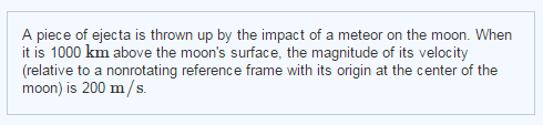

A piece of ejecta is thrown up, what is the velocity

I used this equation:
1/2 mg R^2/ r1 + 1/2 mv1^2 = 1/2 mg R^2/ r2 + 1/2 mv2^2
For r1, it is 1738 km (radius) + 1000 km (above surface) ?
But for r2 , it is on the surface, so would it be 0??

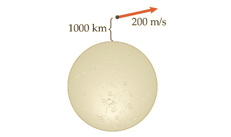

The equations you quote all take radii as being measured from the centre of mass of the moon.
Big R is the radius of the moon
while r is the distance above the surface?
You are given the distance above the surface, but the equations you quote require r to be measured from the mass centre of the gravitational body.
V = 1447.98 m/s ??
nysnacc said:
V = 1447.98 m/s ??
Seems too much. Please post all your working.
-mg R2/ r1 +1/2 m v12 = -mg R2/r2 +1/2 m v22
r1 is radius + distance above > R , r2 = R
so
-g R2/ r1 +1/2 v12 = -g R +1/2 v22
With v1 = 200 m/s, g = 1.62 m/s2
-2g R2/ r1 + 2g R +v12 = v22
-2g {R2/ r1 - R} + v12 = v22
-2(1.62) (17380002/2738000 - 1738000) + (200)2 = v22
So then v2 is sqrt of the left hand side, = 1447.98 m/s

Fair enough... my rough estimate must have had a mistake somewhere. The 200m/s turns out to be insignificant.
But does it make sense to crash the surface at such speed?
Quick lower bound: up to 1738km from surface, g is at least 1.6/22=0.4m/s2. Using v2=2as=800,000m2/s2, v is at least 900m/s.
