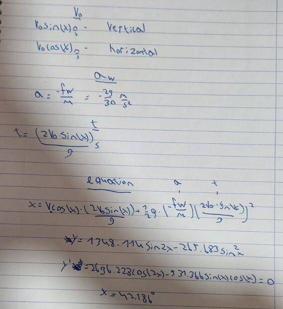

A 1500 kg rocket is launched with a velocity v0 = 115 m/s against a strong wind. The wind exerts a constant horizontal force Fwind = 1450 N on the rocket. What is the rockets maximum range?
R=(V0^2*sin(2a))/g
the first question was At what launch angle will the rocket achieve its maximum range?
and i found the right answer it was 42.186deg.
but now i don't understand what I am doing wrong i put v0,a,g in the equation of range and its wrong and i don't undertand why
here is what i try:
R=(115^2*sin(2*42.186))/9.81
and my answer is 1341.615m
and it was wrong so than i thought maybe i need to divide by 2 and it was still wrong i would like for some help with it because i don't know what else to do.

yes of course about how i found the angle:
i did x0 + v0t+(1/2g*t^2)*(Fw/mg)
i found an equation than i did derivative because they ask about maxium
after i did that i compared the equation to 0 and found x which was 42.186.
about what you said i know how to find the acceleration, about your equation i believes i need to put another equation insted of t but i can't think of any equation that fit, the only one who come to my mind is t=(v-v0)/a but i don't know what is v .
i am really hope that you can help me with that.

That equation, assuming Fw is being given a negative value because the rocket is launched into the wind, gives the x displacement at time t.
You haven't explained how you then involved the launch angle. Please post the rest of your working so that we can advise on the how to find the range from what you have already done.

i hope its ok.
i try to put the t i found in TSny equation -> R=(V0*cos(x))*t but again i got the same result of 1341.615m
Your work shown in the handwritten part of your previous post looks to me like it is correct. But, honestly, it's a notational nightmare. :oldsmile:
Your expression for the time of flight ##t = \frac{2v_0\sin(x)}{g}## is correct, although you don't derive it in your work. Here, you are using ##x## for the unknown launch angle.
Then you write an equation for the horizontal displacement traveled and you use ##x## for both the horizontal distance and the unknown angle:
It looks correct except I don't know what the symbol that I circled in green represents.
Then it appears that you switch from using ##x## as the horizontal displacement to using ##y## as the horizontal displacement. (Often ##y## is used for the vertical displacement.) You then use calculus to find the angle that yields the maximum range. It looks correct.

As I've pointed out a couple of times before, this equation for ##R## does not apply to this problem because this equation does not take into account the wind. But you already have derived the correct equation for the horizontal displacement:
where y is denoting horizontal displacement.
Can you use this to get the maximum horizontal range, R?

No unfortunately i don't know how to find the range from the horizontal displacement equation
Can you define what the word "range" means in this context?
Ohh the horizontal distance i understand so i just need to find the X of this equation?
becuse in order to find the angle i derivative and then find the X so it the same but this time i don't need to do derivative?
Right. You have found the angle that yields the maximum X (horizontal distance). Use this angle to calculate X.
