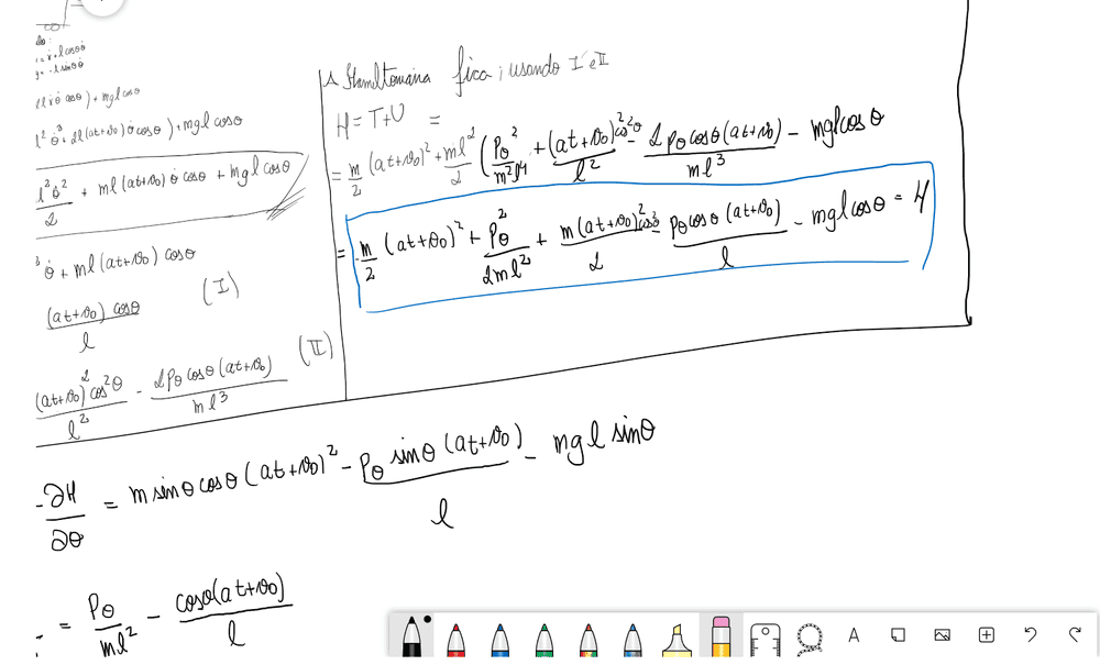

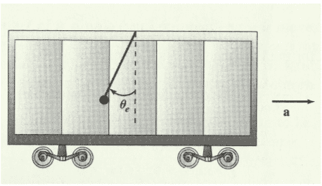

Show that ## \omega = \frac{\sqrt{a^{2}+g^{2} }}{l} ## for small angles
After solving the Hamilton equations, we find that ## \frac{d^{2}\theta}{dt^{2}} = -gsin(\theta)/l- acos(\theta)/l ##
Here is an image of the problem:
The problem consist in finding the moviment equation for the pendulum using Lagrangian and Hamiltonian equations.
I managed to get the equations , which are shown insed the blue box:
Using the hamilton equations, i finally got that the equilibrium angle ##\theta_{e}## : $$\theta_{e} = \tan^{-1}(\frac{-a}{g})$$m which is the angle where ## \frac{d^{2}\theta}{dt^{2}} =0 ##.
Now, i got stuck. I tried to solve an EDO using the small angles aproximation, but it doesn't seems to lead me anywhere, because i don't really have information for the initial values.

You want small angles wrt ##\theta_e##, so work the equation around to ##\theta' = \theta -\theta_e## in first order of ##\theta'##.
Did you understand my post at all ? You want to work with ##\theta'##, not with ##y## .
BvU said:
Did you understand my post at all ? You want to work with θ′, not with y .

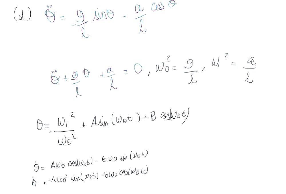

This was another question. About your answer, i used ## \mu = \theta + \theta_{e}## and i got the right answer. Which is the same as you said.

It's the same as before, but now, the acceleration is upwards .
