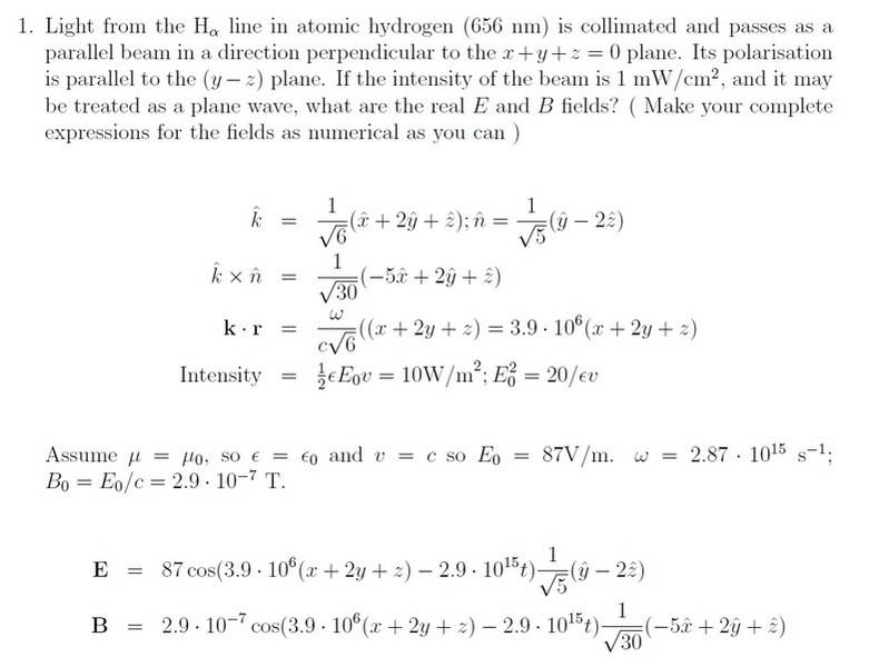

I am having difficulty understanding the very first step of the following solved problem (I understand the rest of the solution).
How did they obtain the expressions for ##\hat{n}## (the direction of polarization), and ##\hat{k}## (the unit vector pointing in the direction of the wave vector)? :confused:
Handwritten-style typeset solution to a polarized plane wave problem: unit vectors k-hat and n-hat, their cross product, k dot r, intensity relations, and final E and B field expressions with cosine terms.
##k=\frac{\omega}{\lambda f} = \frac{\omega}{c}=\frac{2 \pi}{\lambda}##
##E(r, t) = E_0 \ cos (k.r - \omega t) \hat{n}##
##B(r,t) = \frac{1}{c} E_0 \ cos (k.r - \omega t) (\hat{k} \times \hat{n})##
What technique did they use to find the expression ##\frac{1}{\sqrt{6}} (\hat{x}+2\hat{y}+\hat{z})## for the unit vector perpendicular to ##x+y+z=0## plane?
Likewise, how did they get the expression ##\frac{1}{\sqrt{5}} (\hat{y}-2 \hat{z})## for the unit vector parallel to the y-z plane?
I could not find any explanations in my Linear Algebra textbook. So any explanation would be greatly appreciated.
  • Worked solution text showing unit vectors: k-hat = (x + 2y + z)/sqrt(6), n-hat = (y - 2z)/sqrt(5), k-hat cross n-hat = (-5x + 2y + z)/sqrt(30), and k dot r = (omega/(c sqrt(6)))(x + 2y + z) = 3.9 x 10^6 (x + 2y + z); then intensity equations and final E and B field expressions.
blue_leaf77 said:
Where do you get that solution from?
This was the solution provided by my teacher. I don't understand, where did he get he get the expressions for ##\hat{n}## and ##\hat{k}## from?
Well that looks strange to me. If the wavevector should be perpendicular to ##x+y+z=0## plane then this plane must be parallel to the planes of constant phase ##\mathbf{k} \cdot \mathbf{r}=C## with ##C## a constant, in fact this plane is one of them. Which means any plane with equation ##x+y+z=C## is traversed by the beam perpendicularly, and we see the possible unit vector of ##k## that that can form such equation by the dot product with ##\mathbf{r}## must subtend the same angle with all three axes.
But I would like to hear the other's opinion.
