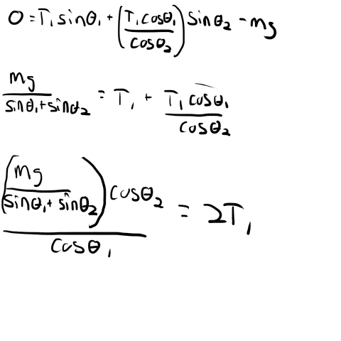

Lets say I keep what I got for T2. Would I substitute that in for the second equation and solve for T1? My algebra is admittedly kind of rusty, and I'm having trouble isolating both T1s by themselves when I do that
In A, you had two starting equations. You used one of the to obtain the relationship between tensions. Use the other one to determine the tensions completely.

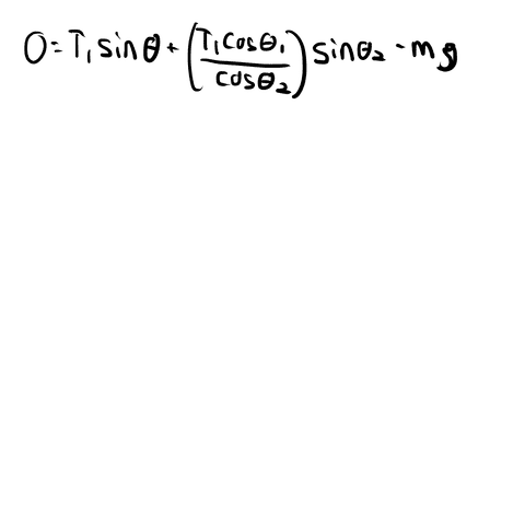

Kind of like this? Or am I not doing this correctly?
EDIT: Obviously I didn't solve this yet, but when solved would this be correct? I haven't solved it because I have trouble getting T1 by itself since there is two of them in the equation
Yes. How would you rewrite 5x+3x so that there is only one x?
This is what I end up getting but it really doesn't seem right. Once again I apologize for my incredibly rusty algebra
No that is not correct. You need to brush up on your algebra.

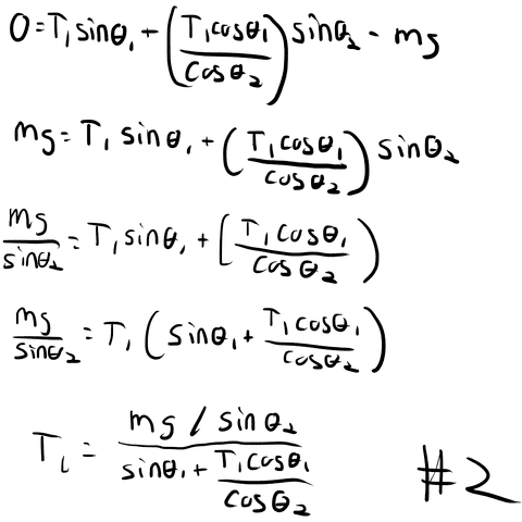

Something like this? I have two versions as I was unsure whether to combine the terms or divide the sin
Thank you all for your replies though, it has been a while since any sort of math class and I know I'm still really rough on it
Version 2 step 2: You should divide both terms on the right by sin theta2

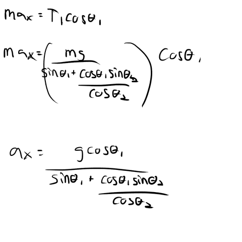

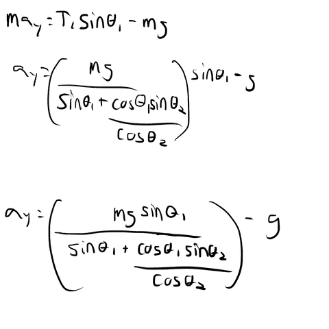

I went ahead and plugged in the equations from part A to solve part B, let me know if I messed up somewhere please
In your ay calculation you failed to cancel an m. There should be no mass terms in the answer.
All your answers can be simplified by multiplying top and bottom by cos theta2. It's a bit ugly having a division inside a division.
There is a quicker way to get (b) having got (a). Since T1 doesn't change, the only difference in the system of forces is the removal of T2. This is equivalent, as far as the mass is concerned, to adding a force -T2. So the acceleration is -T2/m.

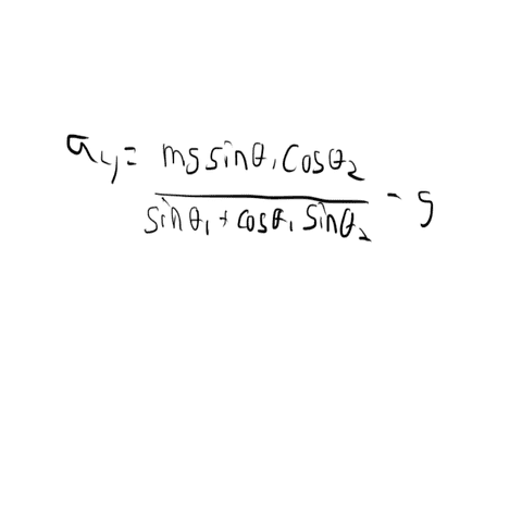

So the final answer would look something like this?
Or am I multiplying the top and bottom wrong?
I aplogize I forget to remove the extra m from this one, but I'm a bit confused as to why it would cancel. The starting equation has 1 m on one side, and 2 on the other. Wouldn't only one m on each side cancel then?
And I'm afraid I'm not quite following why it would only be a = -T2/m. Why would T1 not be factored into it?

The m should cancel as a common factor. If you can't get that to happen, post all your steps.
Since the system is in equilibrium before T2 is removed, the other forces must add up to -T2. When T2 is removed, they still add up to -T2 (since T1 doesn't change).
