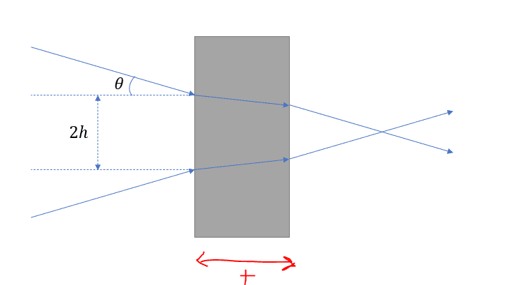

I am so sorry but do you have like a diagram that shows what you're trying to say, I might not able to get which angle and rays that you might be referring to
Yeah, sorry I was being lazy. Here you go:
Two rays incident at angle ##\theta## on a rectangular slab of glass. When they hit the glass, they're separated by a distance of ##2h##. Slab has a thickness ##t##. Find the position of the focal point from ##\theta##, ##h##, ##t##, and ##n## (index of the slab). Expand your answer as a series for small ##\theta##. The lowest term should be cubic and it refers to 3rd order spherical aberration.
Notice that your optical design contains a range of values of ##\theta## from 0 up to your aperture stop. That means your focal point will be smeared out over a range, giving you a caustic.
