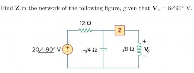

AC Circuit Analysis- Find Impedance

Circuit schematic with a 20∠-90° V source on the left feeding a network: a 12 Ω resistor on top, a -j4 Ω capacitor in the middle branch, an unlabeled impedance Z in a box on the top right, and a j8 Ω inductor leading to the output V_o on the right.
2. The attempt at a solution
Handwritten problem 5 showing a series-parallel AC circuit with a 20 angle -90 degree source, resistors marked R and 12 ohm, a j8 ohm inductor, a -j4 ohm capacitor, and a branch labelled Z, followed by handwritten impedance and voltage-division algebra.
Am I doing something wrong? I know it's just voltage division with AC phasors and we have to equate the real parts and imaginary parts to find the unknown, but I feel like the question shouldn't be this hard.

How you feel is usually irrelevant. Are you satisfied with the answer? Did you check all your work?

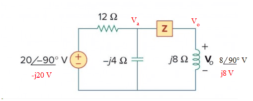

I think you're making it more difficult than it has to be by starting with Z = R + jX, which essentially doubles the number of variables to deal with.
Instead, I would suggest writing Nodal Analysis equations and solving for Z.
AC circuit schematic with a 20 at -90 V source (-j20 V) feeding a 12 ohm resistor to node Va, a -j4 ohm capacitor shunting Va, an impedance Z block between Va and Vo, and a j8 ohm inductor with Vo = 8 at 90 V (j8 V) across it.
Since ##V_o## is already given, you can take advantage of that as that node is "solved" already.
Once you have complex Z you can split it into its R and X components.
