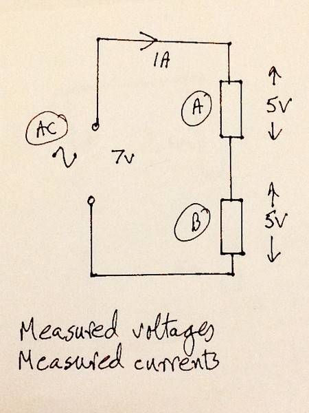

Likewise
see attached and explain
Ps: I will have had enough by post 30 if not before !
The supply is 7 V but it drops 10 V across the impedances? (edit: It occurred to me that your diagram only include magnitudes instead of phasors).

Sorry...very wrong...how can 7V 'drop' to 10V across the impedances?
A (or perhaps it is B) is a capacitance (or is it an inductance?) with a reactance, X, of 5Ω.
B (or perhaps it is A) is a RESISTANCE of 5Ω.
The Impedance (Z) of the circuit is √(5^2 + 5^2) = 7.07Ω
7V supply gives a current of 1A through impedance of 7Ω (I have ignored sig figs)
I will make no further contributions until you can get this sorted out.
I should probably have picked up on this earlier, you're only dealing with the magnitude of the complex voltage, current and impedance.
If A is an ideal inductor with a reactance of 5 Ω (it must be an inductor since the reactance is positive), then its impedance is:
Z_A = (0 + j*5) Ω.
If B is an ideal resistor with a resistance of 5 Ω, then its impedance is:
Z_B = (5 + j*0) Ω.
The equivalent impedance of your circuit, Z, is then:
Z = Z_A + Z_B = (5 + j*5) Ω
For a current I = 1∠0° A, the supply voltage, V, must be:
V = I*Z = (1 + j*0)*(5 + j*5) V = (5 + j*5) V
The magnitude of V is:
|V| = sqrt(5^2 + 5^2) V = 7.071 V
The ratio between the magnitude of V and I is then:
|V|/|I| = 7.071/1 Ω = 7.071 Ω
and now comes the important part:
This is not the impedance of your circuit. It's the magnitude of the impedance.
