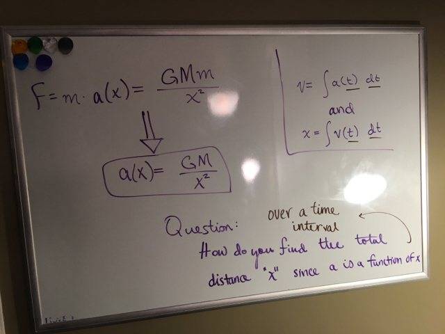

Phys_Boi
49
In 1 dimension ?
BvU said:
In 1 dimension ?
Yes
And is $$F = -\displaystyle {GMm\over x^2} $$ or is $$F = +\displaystyle{GMm\over x^2} $$ as on the whyteboard ?
Positive
I didn't do anything except enter the thing in wolframalpha !
So what does that equation mean?
$$\frac{dv}{dt}=-\frac{GM}{x^2}$$If you multiply both sides of this equation by v=dx/dt, you get:$$v\frac{dv}{dt}=-\frac{MG}{x^2}\frac{dx}{dt}$$Both sides of this equation are exact differentials with respect to time.
So is the following correct?
$$v dv = \frac{-MG}{x^2} dx$$
Yes.
Chestermiller said:
Yes.
So how do you integrate over a time interval? That is to say, how do you find the velocity over the interval [0, t]?
Do you know how to solve for v as a function of x?
