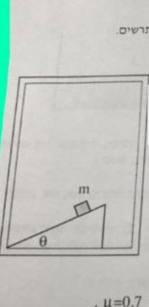

A slope is inside an elevator. A body with the mass of m is on the slope. θ=30°.
What would be the acceleration of the body in relative to the elevator if the elevator rises with an acceleration of 0.5g?
What would be the acceleration of the body in relative to the Earth if the elevator rises with an acceleration of 0.5g?
ma=F
This question got me really confused. When am I supposed to add the fictitious force? When looking at the body in relative to the elevator or in relative to the earth?
The calculation itself is simple, but I can't figure in what case do I need to add the fictitious force. Thanks a lot.
Fictitious forces are used when viewing things from an accelerated frame. So use it in the frame of the elevator.
And when looking at the elevator in relative to the EARTH. I shouldn't add this?
Correct. For the purposes of the question, the Earth frame is near enough inertial.
Right. In the inertial frame of the Earth (close enough, as haruspex says), only "real" forces appear: the normal force and gravity.
You could solve the problem in both frames, but you may find it easier to solve it in one frame then simply transform your answer to the other frame.
ma=F
Inside the elevator, the "effective" gravitational force that is felt by the passengers (and any masses involved in an experiment) is just ##g_{\text{eff.}} = g+ 0.5 \times
g = 1.5\, g.## So you weigh more inside the elevator than you do standing on the ground, and dropped objects fall to the elevator floor faster as well.
Of course, if you filmed that from outside, through the transparent glass walls of an elevator, you would see a dropped object just traveling as usual using the standard Earth's acceleration of gravity, ##g##, but you would also see the elevator floor rising up to meet the object. From inside the elevator it looks like the object is falling faster.
I realize that your problem does not involve a dropped object, but the same downward forces are acting on the object as would be the case if the object were dropped. The ramp is opposing those forces and re-directing the direction of acceleration.

That was really helpful! Thanks.
