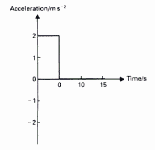

The acceleration-time graph above is drawn for a body which starts from rest and moves in a straight line. The body is of mass 10 kg.
Use the graph to find:
(a) the average distance traveled in 15 s,
(b) the average force acting over the whole 15 s period.
Answers: (a) 125 m, (b) 6.66667 N / 6.2/3 N
(a) v = 2 m s-2 * 5 s = 10 m s
s = 10 m s * 5 s = 50 m
or
s (t) = 1/2 a t2
s = 1/2 * 2 * 152 - 1/2 * 2 * 102 = 125 m
In both cases I assumed that it's 5 and not 0 in the Time/s graph.
But I am completely not sure about the solutions and also if the acceleration was only 5 seconds why can't I get 125 m using just 1/2 * 2 * 52 = 25 m...
Any suggestions please? Thank you in advance.

With regard to method (a), is the velocity of the object = 10 m/s for the whole 5 second period, or just after 5 seconds has elapsed?
Same with calculating the distance traveled. Does the body accelerate at 2 m/s2 for the entire 15 second interval or just the first 5 seconds? What happens to the velocity of the body after the first 5 seconds has elapsed?
Remember, these formulas v = at and s = (1/2) a t2 only apply when the acceleration is a constant. If you have two different values of constant acceleration, you have to apply the formulas to the time intervals which have a constant acceleration separately if the acceleration is a different, though constant, value.

I think the body gains 10 ms velocity at 5 seconds.
It is shown in the graph that the body accelerates for 5 seconds. After than the velocity and acceleration are 0.
How can I apply 0 acceleration? s = 1/2 a t2 = 1/2 * 2 ms * 52 s = 25 meters. The answer is 125 m in the book. Where am I wrong?

I agree that the graph shows that the acceleration of the body is zero after two seconds. But you've lost me on why the velocity is also zero after two seconds.

No, that's not right. It gives you the right answer, but for the wrong reasons.
Look, let's take this in stages. How far does the object travel in the first two seconds, from the origin?
What is the acceleration of the body after two seconds?
What is the velocity of the body after two seconds?
What is the velocity of the body after three seconds? How far has the body traveled, from the origin?
What is the velocity of the body after four seconds? How far has the body traveled, from the origin?
What is the velocity of the body after five seconds? How far has the body traveled, from the origin?

The graph I see has an acceleration of 2m/s2 prior to time, t = 0, and it looks as if the object has that acceleration for the 5 second interval immediately prior to t = 0. Is the object at rest at t = -5s ? The acceleration is zero from t = 0 to 15s.
Which 15 second interval do the questions refer to?
Added in Edit:
Ignore the previous part of this post .
I see that the time axis is simply mislabeled . There is a zero at the 5 second mark instead of a 5 .

If 0 seconds on the vertical axis is 5 seconds then I think the object travels: s = 1/2 a t2 = 1/2 * 2 m s-2 * 52 seconds = 25 meters. The body traveled 25 meters in the first 5 seconds.
After 5 seconds the acceleration is equal to 0 m s-2.
What is the velocity of the body after two seconds? What is the velocity of the body after three seconds? How far has the body traveled, from the origin? What is the velocity of the body after four seconds? How far has the body traveled, from the origin? What is the velocity of the body after five seconds? How far has the body traveled, from the origin?
Hm, should not the velocity be zero after five seconds?

Yes, this is correct.
Why? What does Newton's First Law of Motion say about this?
And you still haven't learned Newton's Fourth Law of Motion: Velocity ain't Acceleration, baby!

I'm sorry, but I don't follow this at all. You've leapt to some sort of unjustifiable conclusion here.
If velocity is expressed as v = 2t, then at t = 0, v = 0, but the acceleration is a = 2, and it remains a = 2, regardless of the value of t.
If the acceleration should become zero, then all this means that whatever the velocity is at that time, it remains unchanged; it doesn't drop to zero.
That's Newton's First Law.

(i) s1 = 1/2 a t2 = 1/2 * 2 m s-2 * 52 s = 25 m
(ii) v = a t = 2 m s-2 * 5 s = 10 m s-1
(iii) s2 = v t = 10 m s-1 * 10 s = 100 m
(iv) sTotal = s1 + s2 = 25 m + 100 m = 125 m
I think this is right.
For (b) part:
F = (m v) / t
F = (10 kg * 10 m s-1) / 15 s = 6.67 N
Does fit the book answer but I don't quite understand why this is the average force? I mean the object has velocity of 10 m s-1 only after the fifth second, before that it has 0, 2, 4, 6, and 8 m s-1 for the 0, 1, 2, 3, and 4 second respectively. If my solution for (b) is right could you explain why we use the same velocity for the whole period of time? (shouldn't the velocity be different for the first four seconds?)

Since the acceleration of the body is constant for 0 ≤ t ≤ 5 sec., then F = ma can be re-written to be F = m * Δv / Δt, where acceleration is the change in velocity Δv divided by the change in time Δt. When 5 ≤ t ≤ 15 sec., the acceleration is zero, which means the net force acting on the body over this interval is also zero, according to F = ma.
So the force for the interval where the body is accelerating is
F = ma = 10 kg * 2 m/s2 = 20 N = (10 kg * 10 m/s) / 5 sec.
The quantity mv = 100 kg-m/s is also known as the momentum of the body during this time.
This force of 20 N is present for 5 sec and is constant during that time, so the area under the force-time curve would be A = 20 N * 5 sec = 100 N-s. After 5 sec, F = 0, so no additional area accumulates under the force-time curve.
The average force = area under the force-time curve, from t = 0 to t = 15 sec., divided by the elapsed time, Δt = 15 sec.
Favg = A / Δt = 100 N-s / 15 s = 6.667 N
