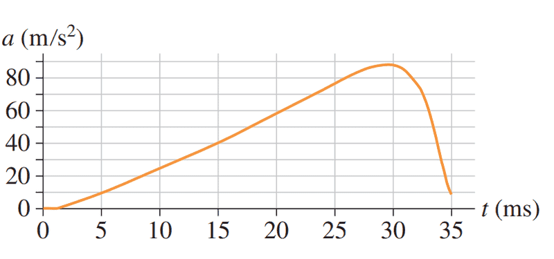

The jumping ability of the African desert locust was measured by placing the insect on a force plate, a platform that can
accurately measure the force that acts on it. When the locust
jumped straight up, its acceleration was measured to follow the
curve in Figure P4.71. What was the maximum force that this
0.50 g locust exerted on the force plate?
Newton's Second Law: F = ma.
At the beginning, I just looked for the highest point in the graph, which is approximately 90 \frac m s^2.
Then I plugged it in the formula F = ma and got the force equaled to 0.045 N.
However, when I looked back, the graph is about the change in acceleration. So really, I'm dealing with acceleration of acceleration. From what I understand, the acceleration increases when the locust jumps up until t is approximately about 27 ms, when it starts to decrease.
The answer I get from my book is 0.084 N. When I plug 0.084 N to the formula F = ma, the acceleration is 168 \frac m s^2
I don't understand how it got 168 \frac m s^2 so that it could get 0.084 N.
Thank you for your help.

The rate of change of acceleration is called jerk. But, that's not relevant here.
I'm not sure how the book got its answer, but you did forget something!

Do you mean the gravitational force?
Yes.

For such a high acceleration, the extra force to overcome gravity is not as significant as it would normally be.

Plus the force to overcome gravity, which adds about 10%.

There is a period when the acceleration increases, and that is what I don't understand. I mean, when you apply a force, the acceleration should be constant.
only if the force is constant.

The acceleration (increasing velocity) of any constant mass is a consequence of the magnitude of the net force that is applied to it.
In this case, the net force increases as time goes by, reaches a peak, and decreases again.
The reason is the mechanism of the legs and muscles of the insect, which provide a different amount of force as they extend.
On the other hand, the weight (force induced by gravity) of the insect remains constant during the process.
The net force mentioned above is the vectorial summation of leg's force and weight.

Because it asks for the maximum force.

I agree, but I don't know why my textbook gives the result as 0.084 N.
It could be a typo or it could be that the person who who provided the solution made a mistake. Wrong solution answers appear once in a while. I agree with your answer.
