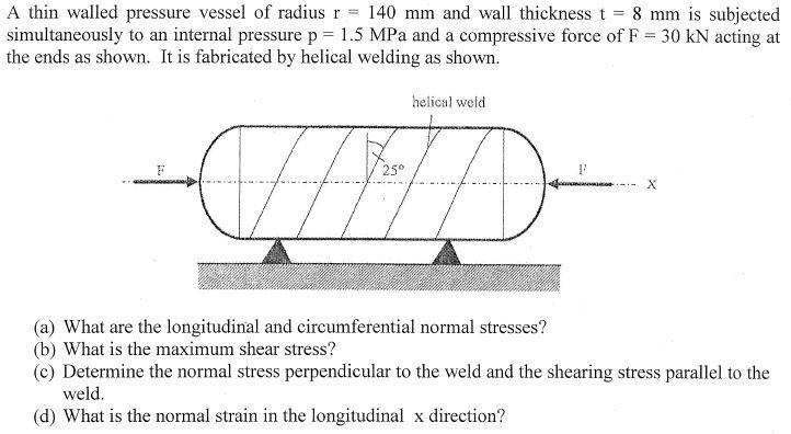

Accounting for Compressive Forces in Thin Wall Pressure Vessels

Description is in the image as well as the question.
I was wondering for a) do i need to take into account the compressive forces that is acting on the vessel?
Cheers
  • Diagram of a horizontal cylindrical pressure vessel resting on two supports, with compressive forces F applied at both ends along the x axis, a helical weld drawn at 25 degrees to the axis, and questions (a) to (d) printed below.
