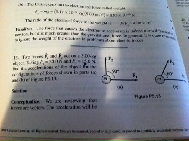

I am not understanding this. This is the question, and the correct solutions for the question I need help with.
I really don't understand how to get the answer here! Can anyone help me? First steps?
Question:

Are you confident with the idea that you have 2 forces which are vectors.
In the first case the vectors (20N and 15N) are at 90 degrees. To find acceleration you divide F by m (5kg) giving 2 acceleration vectors 4 and 3 at 90 degrees.
You need to find the resultant of these 2 perpendicular vectors (pythagoras !)
In the second case the logic is the same but the angle is not 90 degrees.
Is this any help?
