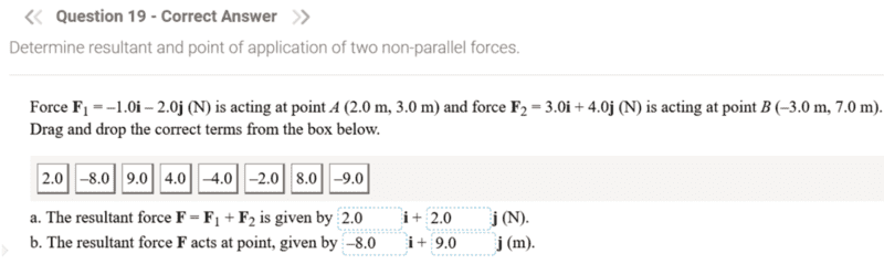

Given two Forces and their position vectors, find the resultant force and the point of application of the resultant Force.
moment = Force * distance
I am struggling with part b of the question attached in the screenshot. For part a, I simply add the components of the given forces.
I tried calculating the moments using vector cross multiplication, but I don't know what to do after that or even if that step is useful.
a. Did you make a sketch ?
b. Please post your working -- and why you think this is useful
c. Post a typed problem statement, not a screenshot. See rules and guidelines
By the way, I agree with your ##{\bf F} = \left (2{\bf \hat\imath}+ 2{\bf \hat\jmath}\right )\ ## N.

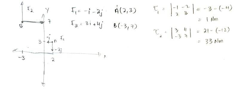

I did make a sketch now and attached my working. I calculated the moments because that is the material I am taking at the moment in class. I realized that the question does not mention that the system is in equilibrium, which is what I have used in previous questions.

Okay! No beauty prizes, but that's not the intention anyway. So you found (I hope) the ##\bf F## total and you found ##\vec\tau_1 = -1\; {\bf \hat k} \ ## Nm and ##\vec\tau_2 = -33 \;{\bf \hat k} \ ## Nm. Useful, because the resultant force and torque must both be the same.
I assume you found ##{\bf F} = \left (2{\bf \hat\imath}+ 2{\bf \hat\jmath}\right )\ ##
So how did you (?) find that
There is no system in this case. It's just the addition of two forces: a mathematical exercise.
Ah, I see. You didn't find: the screen shot is from the solutions manual. :confused:
No wonder I agreed... :smile:
So at this point you have a total ##\vec F## and a total ##\vec \tau## and I think your question boils down to "how do I find an x- and a y-coordinate for "the point where the resultant acts".
Am I right ?

Thank you for the explanation! These are practice questions and I have the solutions for them. Why are your moments negative? From my working, they should be positive. Can you please explain that? From what I have read online, the cross multiplication of two dimensions generates an output that is on the third dimension which you have specified in your working, but why is it negative?
I'm also struggling with this:
Why must they both be the same?
Am I right ?
Yes!
comes out as a result of
I learned ##\vec \tau = \vec r\times\vec F## and I learned $$\vec a\times \vec b=\begin{vmatrix}\hat\imath&\hat\jmath&\hat k\\
a_x&a_y&a_z\\b_x&b_y&b_z\end{vmatrix}$$
And (for me) the sketch is a confirmation of the negative sign of the results: both forces turn clockwise, i.e. negative sense.
So that you have a single resulting force that does the same as the two forces combined
Vector sum of forces is ##{\bf F} = \left (2{\bf \hat\imath}+ 2{\bf \hat\jmath}\right )\ ##
Sum of torques is ##\vec\bf \tau = -34 \;{\bf \hat k} \ ##Nm.
From ##\vec \tau = \vec r\times\vec F## we get for a point ##\vec r## of action:##\tau_z = r_x F_y - r_y F_x ##.
One equation in two unknowns (do you understand why there is one degree of freedom left over ?).

In summary: a force does not have a point of action, but a line of action.
