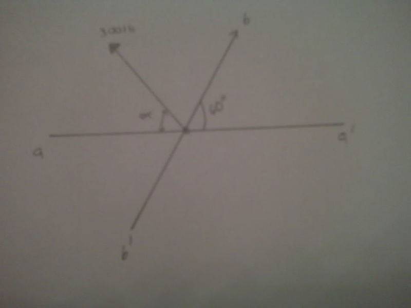

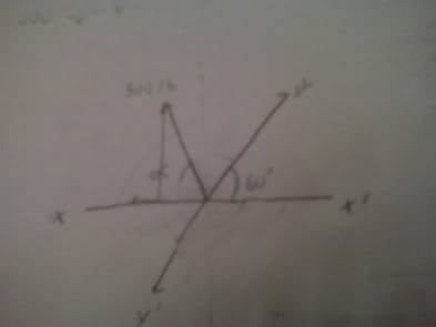

300 lb force is to be resolved into components along a-a(prime) and b-b(prime).
a.) Determine the angle by trigonometry knowing that the compnent along line a-a(prime) is to be 240 lb.
b.) What is the corresponding value of the component b-b(prime)
in the picture i changed a-a(prime) to x-x(prime) and b-b(prime) to y-y(prime)
sin(theata 1)/A=sin(theata 2)
I don't know how to do this seeing as it is tilted?
I'm having trouble understanding the problem and the diagram. I see a vector, a horizontal line label x at one end and x' at the other, and a tilted line labeled y' at one end. Can you restate the problem?
i took a different picture
This is straight from the book...
"The 300-lb force is to be resolved into components along the lines a-a' and b-b'
a.) Determine the angle alpha by trigonometry knowing that the component along line a-a' is to be 240-lb
b.0What is the corresponding value of the component along b-b'

sorry it took me a while to upload it to photobucket, then onto here sorry
does this help?
talaroue said:
does this help?
Yes--it's clear now.
Since you're given the component of the force along a-a', what must alpha be? That's step one. Then you'll have all the angles needed.
Ok, i thought the angle of a-a' would have been 180 since its a straight line. But then its wrong. Then i thought maybe its 120 but then after working through it again it is wrong.

OK. I understand what they want. The axes are not orthogonal, thus to find the a-a' component you must draw a line parallel to b-b' that intersects the tip of the 300-lb vector. You'll get a triangle, two sides of which are given (240 and 300). You'll be able to use some trig to find alpha. (The answer is correct, now that I understand it. :rolleyes:)
(Taking Fcos(alpha) is only good for orthogonal coordinates, not skewed. Sorry about that!)
And to then find the b-b' component, you'll draw a line parallel to a-a' and get another triangle.
so then how do you find the correct angle that they did?
Using some trig. (Law of sines, for one.)
which i orginally had, but the problem was I couldn't figure out what angle i use for axis a-a'
The line that you'll draw parallel to b-b' will also make a 60 degree angle with a-a'. So one of the angles in that triangle is 60. Then use the law of sines to find one other angle. Then find angle alpha.
sin(60)/300=sin(theata)/240
i see now so then i get 43.9
180-60-43.8=76.1!
and then from there i can find b-b'
thank you so much your a life saver
