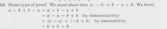

The provided solution in the book used N2 to prove it:
Is my solution valid? If not what is the problem with it? I would really appreciate any feedback because I'm new to thinking about proofs and have no idea what I'm doing.

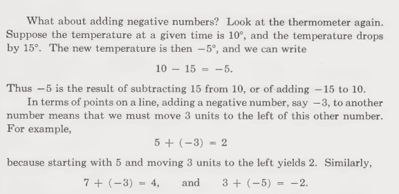

I guess saying -(a - b) = -(a + (-b)) might be wrong because I can't find any rule to justify it. I assumed that - b and + (- b) were assumed to be the same from this section:
But maybe I can't use things from more casually written sections in proofs?
Seems to me that it's covered by N4 or else by the fact that subtracting a number is the same as adding the additive inverse of that number.

Your solution isn't wrong, but perhaps you could look at this problem differently. From an abstract point of view, what is ##-X##, where ##X## is anything? The abstract mathematical answer is that ##-X## is the unique thing that satisfies the equation ##X + (-X) = 0##.
Whereas, you are looking at the ##-## as more like an operator that acts on ##X##.
From that point of view, I very much prefer the book solution.
