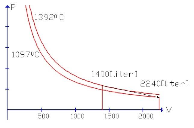

A gas of volume 1400[liter] and pressure 2.33[atm] expands in an adiabatic process to 2240[liter] and 1.2[atm]. plot the process on a V-P diagram.
I shorten the question, only this interests me. the number of moles is given.
Equation of state: ##PV=nRT##
I calculated and drew the two states, see drawing. does the process go along a straight line, like the arrow, from one point to the other?

What relates p and V in an adiabatic process? (Assume ideal gas and quasi-static process).
Now i see that i skipped the material of adiabatic process.
Pand V are related this way: $$PV^\gamma=Const$$ and the lines in the V-P diagram are curved with slopes steeper than the isotherms

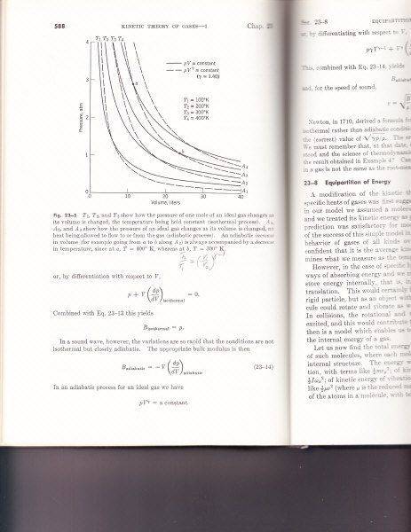

That is better except for the statement about the slopes of the process curves. If an isothermal and an adiabatic intersect at one point (V,p), the steepness favors one curve below that point but the other above th same point.

I didn't understand that, maybe i don't know enough english by saying "favors". the slope of the adiabatic lines is always bigger than the isotherms, so which point do you mean above and below the intersection? i am not at home now and i don't have a drawing program but later i will sketch and explain my question.

Looks like you were right. Here are curves from my textbook showing an isotherm and an adiabatic curve intersecting at a point. The curves diverge as shown but you are right, the slope of the adiabatic curve is always larger in magnitude than the isotherm's. Hope I helped you with the rest anyway! :oops:
PS I wanted to add the attached Hope it's legible.
