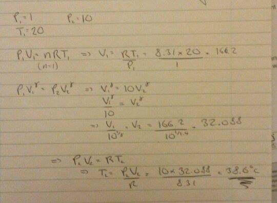

Air at 20C is compressed adiabetically from 1 bar to 10 bar. What will its temperature be?
pV = nRT,
P1P2=T1T2
P1Vλ1=P2V2λ
In picture...[/B]
Is PV = nRT valid for the Celsius temperature scale?
no, should be kelvin 293 right?
Yes, you need to use an absolute temperature scale such as Kelvin.

Are you familiar with the first law of thermodynamics? Are you supposed to assume that the compression takes place reversibly?
