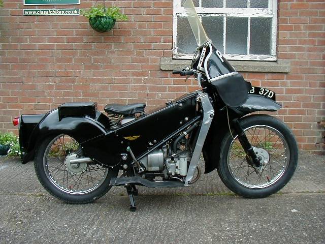

I hope it is acceptable to ask for advice here. I am based in the UK and currently restoring a British 1964 Velocette LE motorcycle. It is fitted with electrical components made by the, now defunct, Miller Company (also British).
The vehicle has a 6V 3 coil alternator with permanent magnets mounted on the flywheel. It is a former police bike and has an uprated alternator which does not convert well to 12V but is rated at something over 60W.
Originally the bike just had a lead acid battery, a selenium rectifier and no regulator but the load was balanced by a very complicated 8 pole switch which switched in the appropriate number of coils depending on the electrical load required. This worked reasonably well with an open vented lead acid battery.
I wish to fit a Cyclon 6V 8Ah sealed battery and understand that this will mean I must fit a regulator. My problem is that nobody seems to make a 6V regulator for an alternator. Podtronics in Texas make a 12V unit which will also allow conversion of the Lucas 6V alternator to 12V but, as mentioned, this is not advisable with my alternator. They also make 6V dynamo regulators.
I have spent considerable time searching for a suitable device but have come to the conclusion I will have to build one. I have the necessary amateur skill to do so but really have no idea about the design i.e. circuit design and component values. I realize heat dissipation is important but the mechanics of that I can deal with.
Any advice would be very gratefully received having spent interminable hours searching for a solution.

I'm not sure, but I think the OP wants to stay with the 6V battery and electicals on the bike. Otherwise, he could just convert over to a 12V system and use standard components.
That is correct I do wish to stay with the 6V system.
The owners club for this particular motorcycle has just lost the services of one of the members who had an in depth knowledge of this particular motorcycle's various electrical incarnations and regularly wrote articles for the club newsletter. I was in correspondence with him shortly before he died and he sent me graphs showing the outputs of the various alternators fitted to these bikes. He pointed out the appalling output of the higher power 6V police machine alternators if converted to 12V, the standard Miller and the Lucas 6V alternators converted satisfactorily.
He did not go into detail about why this was so but was emphatic in not converting my alternator to 12V, hence my problem.

If you plan to use the charger to charge a 6-volt sealed lead acid battery while running the motorcycle accessories, the charging voltage needs to be maintained between about 2.25 to 2.3 volts per cell, so a straight 6 volt charger won't work. Here are articles on lead acid battery voltages for charging:
http://batteryuniversity.com/partone-13.htm
and another:
http://www.powerstream.com/SLA.htm
There are bucking (voltage reducing) switchmode power supply designs that can be bootstrapped; meaning that if the alternator output voltage is less than the regulating voltage, the circuit can be bootstrapped so that the output voltage equals the input voltage. This would allow powering all the motorcycle accessories even if the alternator voltage dropped below about 6.75 volts.

Today I collected a purpose made module from a supplier of parts for old motorbikes. In conversation he told me that he sells around 6 per year because most people convert to 12V. The unit appears well made but is of sealed construction. The whole thing is within a large finned heat sink which measures about 3" x 4" and I am assured will fit the bill.
I do belong to the LE club which, believe it or not has a membership of around 1,000! They have been established for years and acquired engineering drawings and many special tools from Veloce when they went bust in 1971. They also run a comprehensive spares service which makes the LE very easy to restore and maintain.
The LE was used prolifically by police forces during the transition from bicycles to Panda cars. It was felt too dangerous for riders to salute senior officers and so they would nod to a senior officer as they rode past. That is genuinely the reason they became known as Noddy bikes!

I can't say as I've ever seen anything quite like that before. It's very cool and very weird at the same time. The condition looks mint in the photo, though. Good job.
