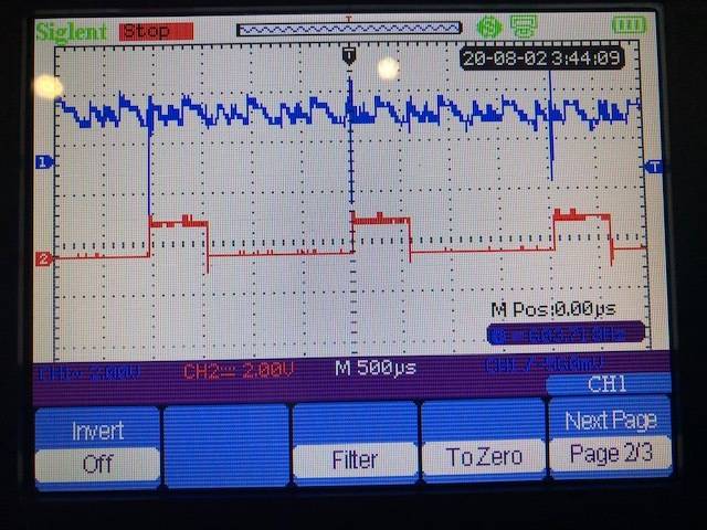

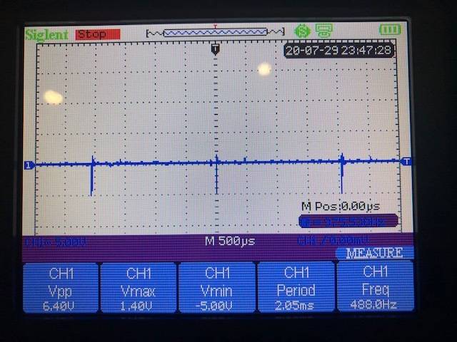

Odd looking 12V waveform on my alternator - I suspect the regulator, and I want to energize the alternator bypassing the regulator to see if that cleans things up
I have a "house" alternator on my van. The 12V rail waveform is attached. The 5V drop-outs are not right, imo.
The alternator is controlled by a Balmar 614 regulator.
http://www.balmar.net/PDF/regulator info s/MC-614.pdfThe spacing of the drop outs leads me to suspect they are synchronous with the state control switching of the voltage regulator - I doubt the belt speed would produce spikes that are 2ms apart like that, it seems more like the micro-controller frequency is driving the spacing of these drop outs. Moreover, changing the van engine idle speed does not change the spacing of these drop outs. I suspect the output of the regulator that is driving the alternator field is not right. If my understanding is correct, its a pwm current output, not a voltage output, so maybe hard to monitor directly.
What I want to do is run the alternator without the regulator attached at less than full field and see if the 12V rail is clean. I am concerned about doing a full field test - I don't want to damage the alternator. The field strength is regulated by a PWM input coming from the regulator pin 4. The regulator manual says one can do a full field test by removing that connector and shorting pin 4 to the 12V rail - I guess that will saturate the coil in the alternator. I don't want to do that - conceptually I'd like to connect the field input to a bench supply and ramp it up slowly to see the output current from the alternator come up and see if its clean / stays clean as I ramp up the field current.
Any thoughts on the wisdom or folly of thei below approach much appreciated.
"connector" in my description below means pins 1-4 shown on page 3 of the regulator manual, there is a picture of "connector" on page 2 of the manual.
Step 1 is to disconnect the connector from the regulator, so the regulator is unpowered and the alternator field is unpowered. I have confirmed this just leaves a clean 12V battery output on the rail with the engine idling - the regulator is dark, and the alternator is spinning freely, field not energized.
I am thinking to take a bench supply, set it to 12V, set the current compliance very low, and use the bench supply to energize the field by conntecting it to the alternator field input with the the plug disconnected from the regulator (so I would just connect the bench supply to pin 4 of that connector, the ground of the bench supply to pin 1 of that connector, and leave pins 2 and 3 floating). I think the alternator will collapse the bench supply if I set the compliance to a few hundred uV and the bench supply will be acting as a current source until I increase the compliance enough to saturate the alternator. I'm not sure how much current will saturate the alternator coils.
Thanks in advance for any advice. I am hoping someone here may have prior experience with alternators and can tell me if my thinking makes any sense.
  • Oscilloscope screen, Siglent, Stop mode, CH1 trace on a flat line with two small downward spikes; measurements show Vpp 6.40V, Vmax 1.40V, Vmin -5.00V, Period 2.05ms, Freq 488.0Hz.

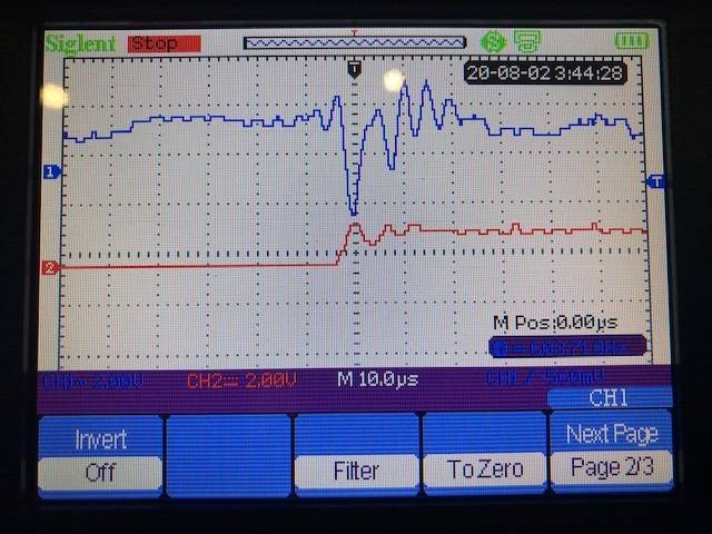

I found the source of the drop outs much more easily than the procedure I asked about above. I tried scoping the PWM output and it does capture a voltage wave quite easily. Its pretty clear the pwm field control edge (red trace) is synched up with the transient on the 12V alternator output (blue trace). Whether its coupling in the regulator or coupling in the alternator I am not sure. I don't see the transient at the battery so the cable parasitics are apparently filtering it out, or else it is somehow fully common mode when measured at the battery terminals. I doubt that because it isn't common mode at the regulator 12V / Gnd connections.
Why do I care (perhaps I should have opened the thread with this) -
There is a 10A fuse on pin 2 of the Balmar connector and I seeing this blow from time to time, and I am trying to debug that.
Anyway, my original question is now moot - if anyone finds this interesting enough to brainstorm whether these transients are normal or not, and whether they might be associated with the fuse blowing or not, I'm happy to hear any theories.

The occassional fuse blowing could be a corroded fuse holder overheating the fuse during heavy loading. It could also be a vibration failure of the fuse if it is mounted on a surface that shakes, even intermittently, or if it flops around and hits something. Vibration fuse failures are common if the old style glass tube fuses are used. If that is the case, replace with the newer automotive fuses tha plug in with two blades and have a plastic body.
The spikes on the Blue trace coincident with the Field pulses remind me of a Grounding problem, probably of the 'scope but could also be that the Ground (common) point of the regulator, alternator, battery is not quite perfect; as in a too-small wire somewhere or again a corroded connection. It could also be that some cable is too long and it was coiled up so it didn't flop around, not terribly likely though.

One thing I was wondering is whether I am seeing a mechanical transient as there might be some compliance in the belt and pulley's, and when the field voltage comes up the load on the belt increases and this causes a drop in the rotational velocity of the rotor as the compliance in the system is 'taken up'
as it were and absorbs a little energy. But then it strikes me as too high a bandwidth ringing to be mechanical and I'd expect some phase difference between the PWM edge and any mechanical play showing up.

Switching transients are normal and occur when the path of the current in the inductive field winding changes from the regulator switch to the freewheeling diode.

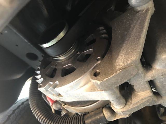

I have this kit installed.
https://www.nationsstarteralternator.com/Sprinter-Van-Dual-Alternator-Kit-p/sprinter-dak-280xp-er-l.htm
The alternator is installed in a factory provided 2nd alternator bracket, its location is at the bottom of the engine compartment, behind and below the grill, roughly behind and lower than the passenger side headlight. I am attaching a picture I took lying on my back on the ground looking up at the alternator. The tire you see is the front passenger side tire. You can see the pulley to the in the upper left of the image. No fan on the pulley. I did not check the size, but it came from the alternator mfr themselves, I am assuming they have it sized correctly.
Underside view of a vehicle engine bay showing an alternator pulley with a toothed belt-drive face, mounted on a cast bracket next to a black hose and a tire.

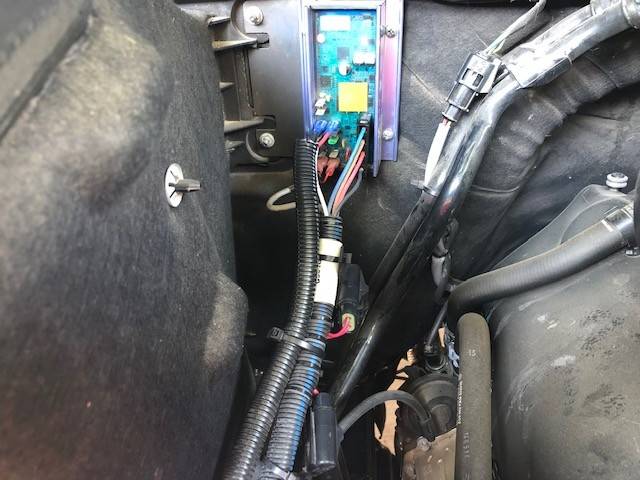

I also attached a picture of the regulator installation at the top of the engine compartment on the back wall, adjacent to the passenger compartment, passenger side, perhaps 3 feet away from the alternator.
Photo inside a van engine compartment of a green circuit board regulator mounted on a bracket, with black wiring harness and red and blue wires leading from it.
Could be an airflow problem.
You mentioned testing at a "high idle speed" which I took to mean while parked. Your photo shows the alternator mounted rather low in the chassis and something (front bumper?) directly in front of it. You might try a road test on the open highway to see if it still overheats. If it's OK on the highway you will need to find a way for more airflow when parked. (add a dedicated fan? Or possibly a duct from the radiator fan, but that may be too hot.)
Another thing to check: Is it mounted close to the exhaust system? If so, a piece of sheetmetal mounted between the two would help.
I hope the regulator has at least a cover that was removed for the photo. It WILL get damp or wet. At least a splash shield could be added to extend its lifetime. Those connectors do not appear to be splashproof either, and as such, they will likely corrode over time.

You can't tell from the photo, but the regulator is completely sealed with a clear potting compound, the connectors extrude from the compound.
