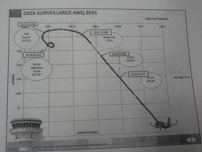

What instrument failure could cause the excessively high climb rate readout? Even if they were climbing hard, that climb rate looks wrong...
  • #41
Wasn't the climb rate based on ground based radar data?
Well...clearly "wrong" insofar as it probably caused (or was caused by the same thing that caused) the crash.
  • #42
Oops, yes you're right Russ. The article I was reading was mostly about the black boxes, but re-reading it, it does say the climb data was from radar. Thanks.
  • #43
FYI:
In a severe thunderstorm, an updraft alone can cause a 6,000 fpm (68 mph) climb rate:
