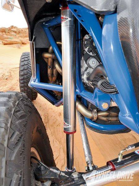

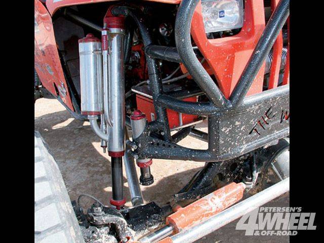

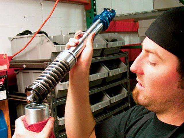

4WheelOffRoad.com said:Air shocks are a compromise between a shock and a spring. They are very similar to nitrogen-charged emulsion shocks. However, you will quickly notice that air shocks have a much larger chrome shaft that runs out of the body.
These new air shocks look very much like the coilover shocks used by desert racers and rockcrawlers, but without the coil springs around the outside of the shock body. What really makes folks scratch their head is that no other type of spring is used with air shocks-no coils, leaves, or airbags. The air shock itself works as both spring and shock in a cheap, lightweight, and simple package...
monty37 said:if we do use air shocks type for off-road vehicles won't there be any air leak problems ?
