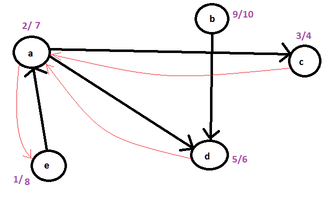

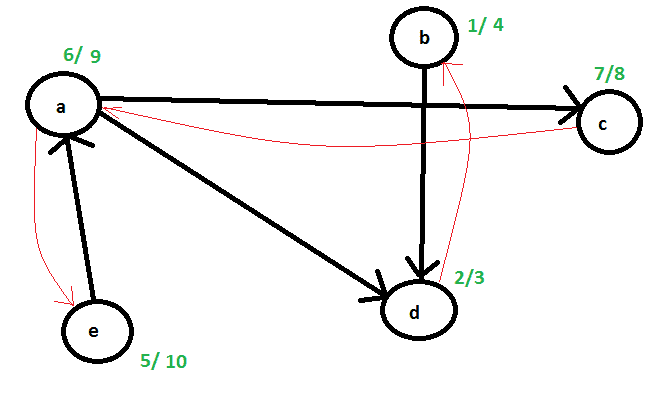

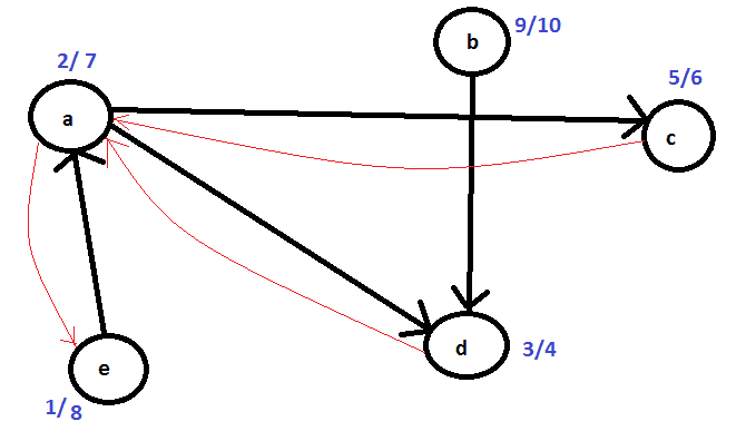

Yes, it would.. But DFS doesn't always return the same result. If we apply for example twice the DFS at a graph and at one step, there are two different nodes to visit, we can once visit firstly the first node and the second time when we apply the algorithm we would visit firstly the second node and so the results would be different, since the finishing times would be different.For example if we have this graph:View attachment 4263
applying DFS we could get these discovery and finishing times:View attachment 4264these ones:View attachment 4265
or these ones:
View attachment 4266So at the first case, the result of the topological sorting would be: {b, e, a, d, c}, at the second case the result would be: { b, e, a, c, d} and at the third case: {e, a, c, b, d}.How could an algorithm return all these possible results of topological sorting?

  • #34
I don't understand. (Sweating)
What do your arrows and your numbers mean? (Wondering)

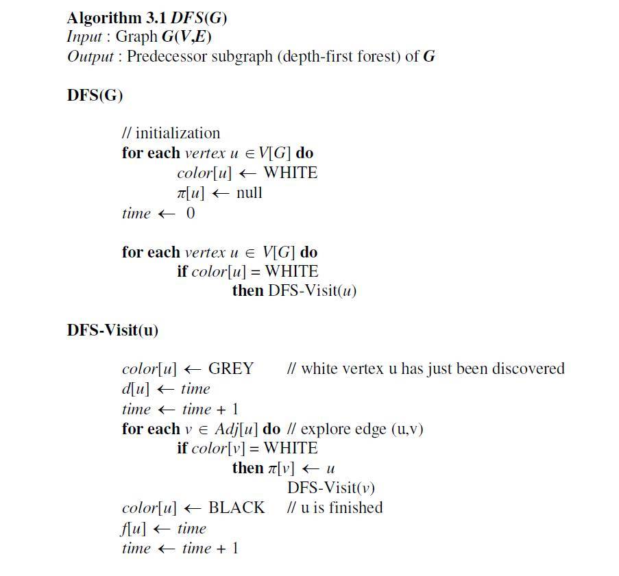

The DFS procedure takes as input a graph $G$, and outputs its predecessor subgraph in the form of a depth-first forest. In addition, it assigns two timestamps to each vertex: discovery and finishing time.
The algorithm initializes each vertex to “white” to indicate that they are not discovered yet.
It also sets each vertex’s parent to null. The procedure begins by selecting one vertex u from the graph, setting its color to “grey” to indicate that the vertex is now discovered(but not finished) and assigning to it discovery time 0.
For each vertex v that belongs to the set Adj, and is still marked as “white”, DFS-Visit is called recursively, assigning to each vertex the appropriate discovery time d[v] (the time variable is incremented at each step).
If no white descendant of v exists, then v becomes black and is assigned the appropriate finishing time, and the algorithm returns to the exploration of v’s ancestor (v).
If all of u’s descendants are black, u becomes black and if there are no other white
vertices in the graph, the algorithm reaches a finishing state, otherwise a new “source” vertex is
selected, from the remaining white vertices, and the procedure continues as before.

  • #38

Ah! That explains it. (Mmm)
