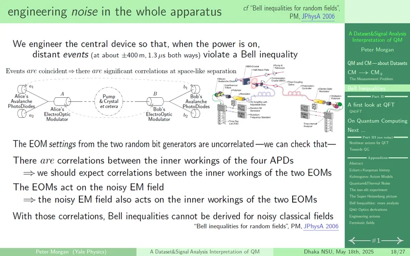

Slide titled 'engineering noise in the whole apparatus' showing a schematic of Alice's and Bob's avalanche photodiodes and electro-optic modulators linked by a central pump and crystal, with a photo of a laboratory apparatus at right.
The diagram at upper right is from page 60 of Gregor Weihs's thesis (which gives more detail about the apparatus than the PRL from 1998, in this case with English annotations, from Gregor, personal communication.) The idealized diagram of the same apparatus at upper left is from §7.2 of an article of mine in Annals of Physics 2020.
The two devices that apply the recorded choice to the electromagnetic field are called ElectroOptic Modulators in this experiment. They switch between zero applied voltage and ~1000 Volts in less than a microsecond, so there's a lot going on inside them.
If we think of the apparatus as enclosing and conditioning the noisy electromagnetic field —to engineer the statistics of the events in the Avalanche PhotoDiodes so they violate a Bell inequality, very much nontrivially— instead of as about two particles, there are measured correlations between events in the Avalanche PhotoDiodes, so we cannot claim that there are no correlations whatsoever between the inner workings of the ElectroOptic Modulators.
To understand that in a broader perspective, perhaps try the whole talk (there's a link in the video description to a PDF of the slides, so you can try that to see whether you want to take the time to watch the whole colloquium. Slides 15-19 are about Gregor Weihs's experiment.)
To circle back to your question about CFD, I construct what I call QND Optics as a commutative subalgebra within Quantum Optics that is loosely comparable to Bohmian trajectories for a QFT, except that it is linear, Lorentz invariant, and more measurement theoretic (see slides 24-25, though the slides before that are necessary to understand the notation.) I think it's preferable to work with a sophisticated measurement theory that can accommodate multiple apparatuses and data analyses in a single mathematical structure, however I find the field theoretic mathematics of QND Optics makes me mostly unworried about CFD for particle properties.

Concerning 3), even if there no dependencies of the controlled settings in the apparatus (which we can verify because we have a list of the binary values that were used, to which we can apply statistical tests), there will be dependencies between uncontrolled degrees of freedom of the two devices that apply that choice to the electromagnetic field.
I discuss this at some length in an article in JPhysA 2006 (though sadly not clearly enough, which is why it is not well-known.) Here's how I now talk about this, from a colloquium for NSU Dhaka on May 18th:
Sorry, not sure to understand your apparatus/setup. Is it a Bohm-type EPR kind of experiment ? From a correlation perspective, it seems like you're actually refuting measurement independence (no conspiracy). Are you talking about a sort of superdeterminism ?

Sorry, not sure to got your apparatus/setup. Is it a Bohm-type EPR kind of experiment ? From a correlation perspective, it seems loke you're actually refuting measurement independence (no conspiracy). Are you talking about a sort of superdeterminism ?
It's Gregor Weihs's experiment from the mid-1990s, demonstrating a violation of a Bell-CHSH inequality, which is closely related to Bohm's version of EPR (except that it's for photons, not for fermions.) On arXiv, with a link there to PRL, that's "Violation of Bell's inequality under strict Einstein locality conditions", https://arxiv.org/abs/quant-ph/9810080. That was the classic experiment of its kind for over a decade, which is part of why I use it, but it is also significantly simpler in operation than more recent experiments, which typically include heralding and other subtleties.
