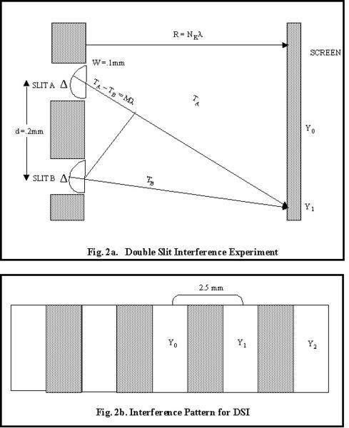

THE DMI MODEL OF THE DOUBLE SLIT EXPERIMENT
Applying the DMI model to the double-slit interference experiment now becomes straightforward.
Figure (2a) shows the DSI experiment, with the same values for R, W, and [tex]\lambda[/tex], as in the single-slit example just discussed. The slit separation, d, is .2 mm. For clarity, the slit barrier side of the experiment has been greatly exaggerated.
Recall the wave-model condition for a bright interference fringe at a point, [tex]P_Y[/tex], on the screen:
[tex]P_{A}-P_{B}=M\lambda[/tex] and​
[tex](N_{A}+K_{A})\lambda-(N_{B}+K_{B})\lambda=M\lambda \ \ \ \ \ \ Eq. \ 14[/tex]​
where the left hand terms are the expressions for the wave-model path lengths.
In the DMI model, these expressions are simply replaced by ones which include the start point uncertainty, [tex]\Delta[/tex]:
[tex]T_{a} = (N_{a}+K_{a}+\Delta)\lambda[/tex]​
[tex]T_{b} = (N_{b}+K_{b}+\Delta)\lambda\ \ \ \ \ \ Eq. \ 15[/tex]​
It is important to note that, for each event, the uncertainty, [tex]\Delta[/tex], is the same for both slits; this is because the uncertainty applies to the start point of a single particle trajectory—that is, a single event—which must originate at only 1 of the 2 possible slits.
Substitution of the DMI trajectories (Eq.15) into the wave-model interference condition (Eq.14) has no effect; since the variable [tex]\Delta[/tex] is the same for both trajectories [tex]T_{a}[/tex] and [tex]T_{b}[/tex], it simply cancels out.
The underlying geometrical framework of both the wave and DMI models is seen to be identical, and predictions from one model must carry over to the other. The observed outcomes, if not the underlying physical basis, of both models are the same.
Fig 2b shows the interference pattern resulting from the DSI experiment of Fig. 2a. The pattern is described by the conventional wave-model equation:
[tex]Y_{M}=\frac{(M \lambda R)}{d}\ \ \ \ \ \ Eq. \ 16[/tex]​
where, again, M = {0…1…2…3…etc.}, R = 1 m, [tex]\lambda[/tex] = 500 nm, and
d = .2 mm.
Substituting the values {0,1,2,3…etc.} for M gives the displacements for the first few interference maxima:
[tex]Y_{0} \sim 0[/tex]​
[tex]Y_{1} \sim 2.5\ millimeters[/tex]​
[tex]Y_{2} \sim 5.0\ mm[/tex]​
[tex]Y_{3} \sim 7.5\ mm[/tex]...,etc.​
This result, as predicted by both the wave and DMI models, agrees exactly with that which is experimentally observed.

Given these points which seem to presume the basis of QM I'm not sure I see an advantage for the theory :smile DTF​
Quantum diffraction
Hello:
This proposal looks wrong to me based on the well understood observation of quantum diffraction that happens when one slit is used on a coherent light source. One sees an interference pattern after the peak. That is not what is shown in figure 1. Quantum diffraction doesn't get nearly the same amount of airplay as quantum interference, but shows Nature is consistent. Since figure 1 disagrees with observation, this alternative is not viable.
I am at peace with this issue. In my living room, I have a piece of art titled "Groups of coherent photons behave like waves and particles". Words #1 and #3 are critical to understand in this context.
It appears like your model does not deal with the issue of coherence, which indicates to me the logic is wrong. A coherent light source will show the interference pattern in the two slit experiment, and an incoherent light source will not. Therefore coherence is vital to understanding this issue.
Hi:
The theory is not about particles but waves, and so can only give the same answers as the usual wave treatments. I base this on the following argument.
If we define the dB wavelength in the way you do, then a trajectory becomes a series of points which lie close togther along the classical trajectory. Consider a second trajectory for a particle of equal momentum. Will the dots line up ? You have a hidden phase in your model which I suspect is your Delta (uncertainty). Sweetser above makes a similar point when he cites coherence, which depend on phase.
I don't think there's anything new in this theory.
You may be interested to look at Bohmian QM where trajectories are wavy and cross the classical trajectory at intervals equal to the dB wavelength.

Hello. Thank you for reading (and responding!) to this post.
I completely agree with you that this alternative model adds nothing new to conventional QM theory, but it was never intended to do so. QM formalism, as it stands, is a supremely successful theory, and has withstood every experimental test to which it has been put.
However, QM theory does leave the door open for interpretation of some of the underlying physical elements (specifically, for the DSI Experiment, the question of "what goes through the slits?")...and there are several such interpretations around (Everett's "Many Worlds", Cramer's "Transactional", the Bohm interpretation, etc.).
My proposal offers a new physical interpretation for DeBroglie's particle wavelength..."the discrete motion interpretation", and the consequence of this is the emulation of wave-like behavior by individual particles. The possible advantage of this approach is via Occam's Razor: the wave particle duality paradox is avoided (the quanta are always treated as particles), and physical non-locality is replaced by a hopefully more palatable form of geometrical non-locality. Of course, my DMI model comes with its own form of quantum "weirdness" - particle-like quanta "jump" across the DeBroglie wavelength - and this directly challenges the assumption of continuous motion.
Again, I thank you for your very thoughtful comment.
