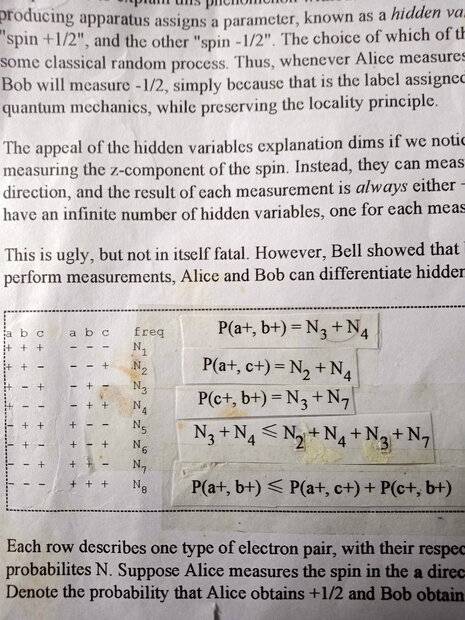

It seems the major premise for the derivation of Bell Inequalities is Counterfactual Definiteness for both electrons and photons : For electrons the spins at x, y, z directions are expected from conservation laws. See table. And for photons the eight polarization types along three orientations interact with nine pairs of detector settings. In each case electrons , photons the inequality does not hold. Seems this could be more from non Counterfactual Definiteness rather that quantum Non Locality. Especially since the expectations are based on three values and the experiments only measure two different settings. https://chem.libretexts.org/Bookshelves/Physical_and_Theoretical_Chemistry_Textbook_Maps/Quantum_Tutorials_(Rioux)/08:_Quantum_Teleportation/8.29:_Spooky_Action_at_a_Distance-_The_EPR_Experiment_with_Photons.
Printed page with a table of eight electron spin combinations (a, b, c columns with + and - signs, frequencies N1 to N8) and handwritten-annotated inequality expressions relating probabilities P(a+, b+), P(a+, c+), P(c+, b+).
Handwritten-style table of 72 rows of polarizer encounter types (YYY, YYN, ... NNN) against detector settings 11, 22, 33, 12, 21, 13, 31, 23, 32, marked Same or Different, with paragraphs of printed text above and below.

1. It seems the major premise for the derivation of Bell Inequalities is Counterfactual Definiteness for both electrons and photons : For electrons the spins at x, y, z directions are expected from conservation laws. See table. And for photons the eight polarization types along three orientations interact with nine pairs of detector settings. In each case electrons , photons the inequality does not hold. Seems this could be more from non Counterfactual Definiteness rather that quantum Non Locality.
2. Especially since the expectations are based on three values and the experiments only measure two different settings. ...
I don't know about the "major premise" designation for counterfactual definiteness (CD) fork of the Bell argument, since locality is also part and parcel of that argument - which of course effectively refutes local realism. But sure, Bell tests cast a lot of doubt on CD.
1. There are usually 3 or 4 polarization angle settings in Bell tests, depending on the specific inequality derived. However, theory says there are also perfect correlations (anti-correlations) at all identical angle settings. That means there must be counterfactual definiteness for a large (or perhaps infinite) range of angles. If there are, what are they? There is no way to describe such an array of possible outcomes that will produce results which match the predictions of QM.
2. If there is CD, then this argument does not matter - although I do see it put forward from time to time. Either those other settings would produce a definite value independent of the partner particle (as CD claims), or there is no CD.
