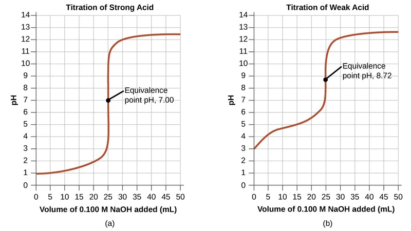

Consider the appearance of a weak acid titrated strong base titration curve (right)
If you overshoot the equivalence point by just 0.05-0.1 ml your pH goes from 8.72 to to 11-12 (approx). Your source of high pH is (unsurprisingly) due to excess strong base.

Phenolpthalein changes color at pH ≥ 8.3. It would therefore be colorless a pH 7. It is a misconception that phenolpthalein indicates the equivalence point, but it changes color at the endpoint, i.e. after all of the weak acid has been depleted and the solution is no longer buffered.
Colorimetric titration (such as phenolpthalein) is seldom useful in real life and potentiometric (pH meter in solution) is much more reliable.

Also about those graphs in post #4, the one on the right hand side looks like titration of a diprotic weak acid. First "equivalence" point appears to be about pH 4.

Not quite. The region before the inflection of the equivalence point is governed by the Henderson-Hasselbalch equation.
The region around the equivalence point must be modeled differently, as it exists in the limit of [HA] -> 0, where the equation approaches infinity and afterwards there is no acidic medium and only strong base, and the HH equation is not applicable. Instead pH = -log([H+]).
Of course for di- and multiprotic acids, the region after the equivalence points (except the last) are also modelled after the HH equation, which is why we can determine multiple pKa values.
Some non-idealities contribute to deviations from the fitting of the log function.

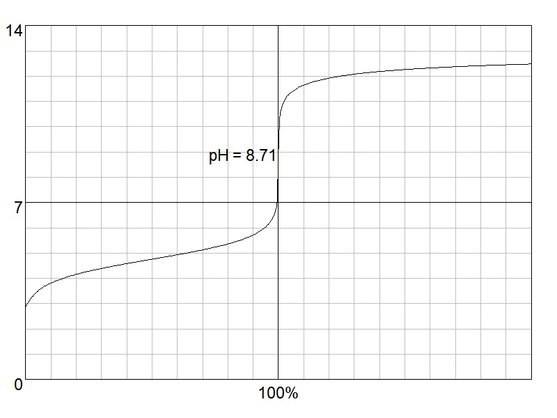

Nope, looks perfectly OK to me - 0.1 M acetic acid plus 0.1 M NaOH.

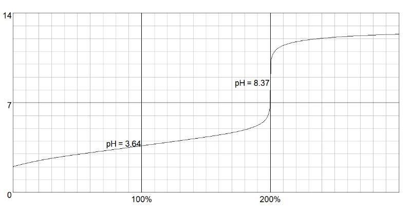

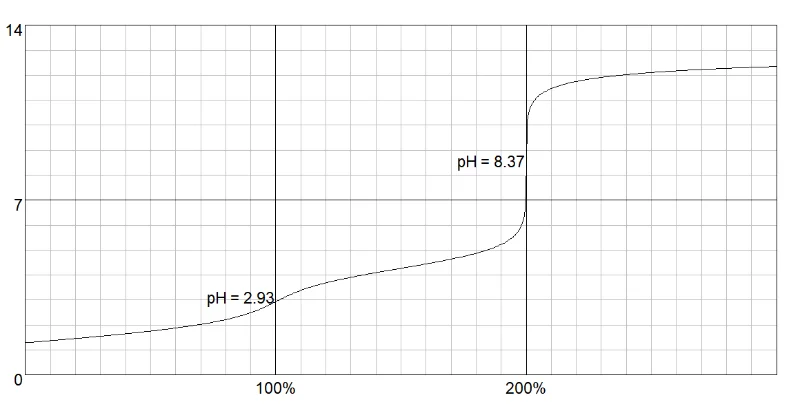

Diprotic looks either differently - oxalic acid (pKa1 = 1.252, pKa2 = 4.266)
or if the difference between pKa1 and pKa2 gets lower, very similar to just the weak acid, with longer initial slope, and there is no first endpoint visible (here - pKas of 3 and 4.266)
Borek what I say is that the graph on the right looks like it is showing a pH change, not too strong, but a pH change at about the 5 ml. mark, pH 4. That looks to me like a first-proton neutralization. The second proton neutralization at pH 8.

See my post. The first region is governed by the Henderson-Hasselbalch equation. It is indeed called the buffer equation in some texts.
I know the "turn" doesnt look truly logarithmic but this could simply be an experimental error, such as not allowing the system to properly reach equilibrium between measurements.

I understand what you are saying, by my experience tells me otherwise - compare the curves I calculated (just as examples of what to expect from monoprotic and diprotic acids) with the curve in question.
Besides, if the acid is diprotic, how come first equivalence is at 5 mL, and the second at 25? If anything, it should be at 10 mL.
