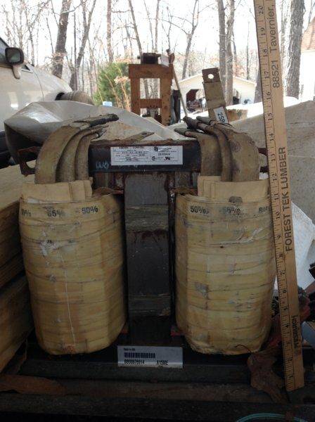

it was part of an autotransformer based reduced voltage starter
Holy crap; that's a monster. Thanks for the photo.

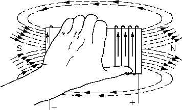

Something I just learned, thanks to you, from investigating magnetomotive force(MMF); the Left-hand Rule to Find North Pole of an Electromagnet:

Conventional or electron current ?
Now i got to try it...
I believe your diagram is incorrect.

I was thinking the same, but seeing Jim's #34, it is electron current and not conventional current. So the right hand rule becomes left hand rule.
electron current

Yes. You're right.
