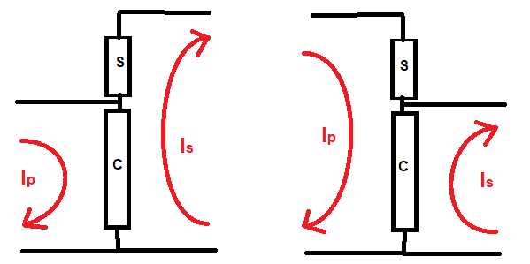

I don't know whether it helps at all, but I like to think of the primary and secondary currents both flowing through the common winding.
So in the step up version, the full primary current flows through the common winding and the full secondary current flows through both the common and series windings. Similarly in the step down, Ip flows through both and Is only through common.
In both cases, in the common winding they are in the opposite sense, so the net current is lowered.there.
For the series winding there is one current flowing, either the full secondary current in the step up case or the full primary current in the step down case. It is meaningless to ask whether that current comes from the supply or the other winding - it comes from the node between the the two windings.
You can see easily that the efficiency is greatest when the two currents are closest, since then they nearly cancel. So for small step up or down, the voltage ratio is near to 1 and the current ratio will also be near to 1. Then the common winding is much larger than the series winding and the common winding carries very little net current.
For your high current step down transformer, the one turn common winding needs to be thick to carry 992 A, but the primary series winding carries only a bit over 8 A and can be much thinner wire. There is not much advantage here over a double wound transformer with 120 turn primary carrying 8 A and 1 turn secondary carrying 1000 A. I understand that thinking of the primary current splitting (in the step up case) is another valid viewpoint, but I don't see how it is helpful in either understanding or analysing the autotransformer.
I also don't like the idea that current is transferred inductively. In my view it is energy that is being transferred - which is why the current ratio is the inverse of the voltage ratio. Again, I see no benefit of talking about current transfer: it's just another way of obscuring the simple relations that do exist.
When the two currents are closest and they nearly cancel then the load would have minimal current (Is=Ip+ I' below).. why do you say it's more efficient?
Unless you mean the primary current will cancel while the secondary current add up?
What if the primary current doesn't cancel or large?
For your high current step down transformer, the one turn common winding needs to be thick to carry 992 A, but the primary series winding carries only a bit over 8 A and can be much thinner wire. There is not much advantage here over a double wound transformer with 120 turn primary carrying 8 A and 1 turn secondary carrying 1000 A.I understand that thinking of the primary current splitting (in the step up case) is another valid viewpoint, but I don't see how it is helpful in either understanding or analysing the autotransformer.
No. It IS the load that determines the current. The load voltage will be equal to the fraction of the primary voltage determined by where the load is connected to the winding. If the secondary tap is at 30% of the winding you will get 30% of the primary voltage across the load, then the load impedance will determine the amount of secondary current. Then the primary current will be determined from the secondary current and the transformer ratio.
Think of the voltage being determined from the primary side and, as the consequence, the current being determined from the secondary side.
