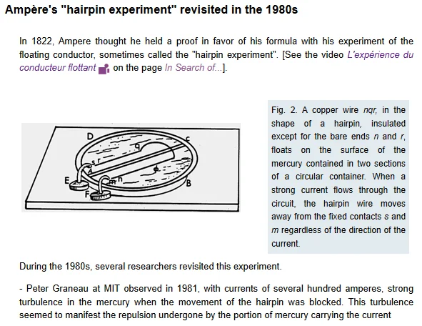

Now imagine continuously deforming the loop, shrinking it until it becomes Ampère's mercury trough experiment: a short bar floating on mercury, with the return current flowing immediately beneath it in the liquid. The bar moves, it "wants to expand the loop."
But in this limit, by symmetry, B at the bar's location is essentially zero. The Lorentz force description becomes problematic, while the gradient of A remains well-defined and still explains the force.

I think a convincing explanation is the following, because a magnetic field only from the moving part of the circuit does not contribute to Newton's 3rd law:
Peter Graneau at MIT observed in 1981, with currents of several hundred amperes, strong turbulence in the mercury when the movement of the hairpin was blocked. This turbulence seemed to manifest the repulsion undergone by the portion of mercury carrying the current.
A paper from Peter Graneau from 1987:
https://isidore.co/misc/Physics pap...ian recoil and the efficiency of railguns.pdf
