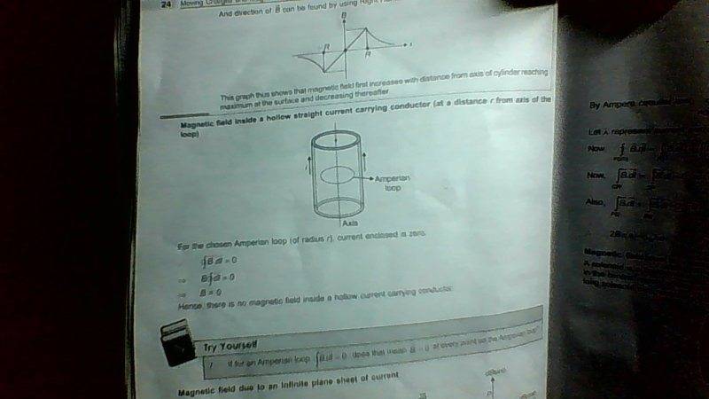

I've just been introduced to Ampere's circuital Law to calculate magnetic field. I saw in a derivation for the magnetic field inside hollow straight current carrying conductor that the integral of B.dl was zero because no current was passing through the surface of the loop. This was used to imply B=0.
However, it is mentioned ∫B.dl=0 does not mean B=0 at every point on the loop. I'm confused since ∫dl (length of loop) cannot be zero therefore B has to be zero. Where am I wrong?

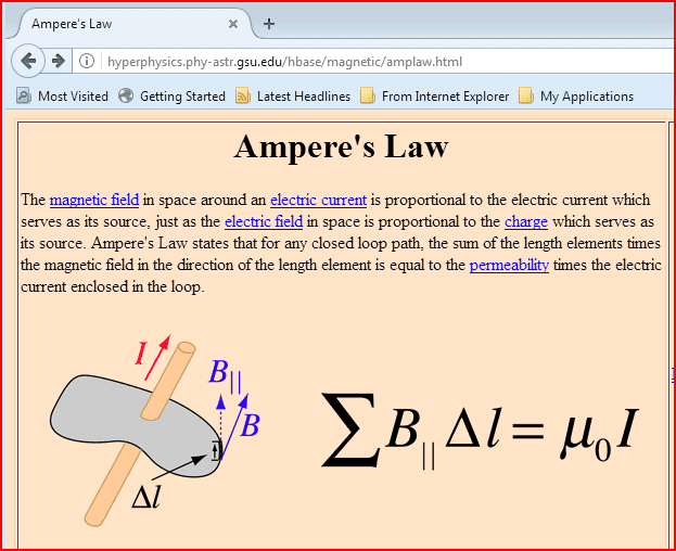

It's a vector equation. What happens when B points different ways in different parts of the path integral? :smile:

Take the case of a closed path enclosing a single wire carrying a current I. Then the quantity B⋅dl will have the same sign all the way around the loop, and the path integral will give a non-zero result. But if you have two wires enclosed by that path, and the wires carry equal and opposite currents, what happens to the overall path integral?

Ah! the net current through the surface enclosed by the loop is zero when there are two wires carrying equal and opposite currents which gives ∫B.dl=0 bu there's still a magnetic field everywhere on the surface.
So am I correct in saying that the only thing we can say with certainty when ∫B.dl is 0 is that the net current through the surface is zero?

Correct. There are B components pointing in opposite directions around the circumference of the loop, and in total they sum to zero. But at any particular point along that path, the sum of the B components from the two wires may not necessarily be zero.

what is the difference between the case when there are two wires carrying current in opposite directions and in case 2 when we're talking about the inside of a hollow straight current carrying conductor.My textbooks says for case 2 I(enclosed)=0, so ∫B.dl=0⇒B∫dl=0⇒B=0 while its clearly not so in case 1.
Can you Upload a diagram for case 2? B can only be taken out of the integral if it does not depend on the position along the path. So unless B(l)=constant all along the path, it needs to be part of the integration.
Sorry about the quality, I don't have a decent camera.
B is constant, every point on the circle is the same w.r.t to the cylinder and their respective fields cancel out.
