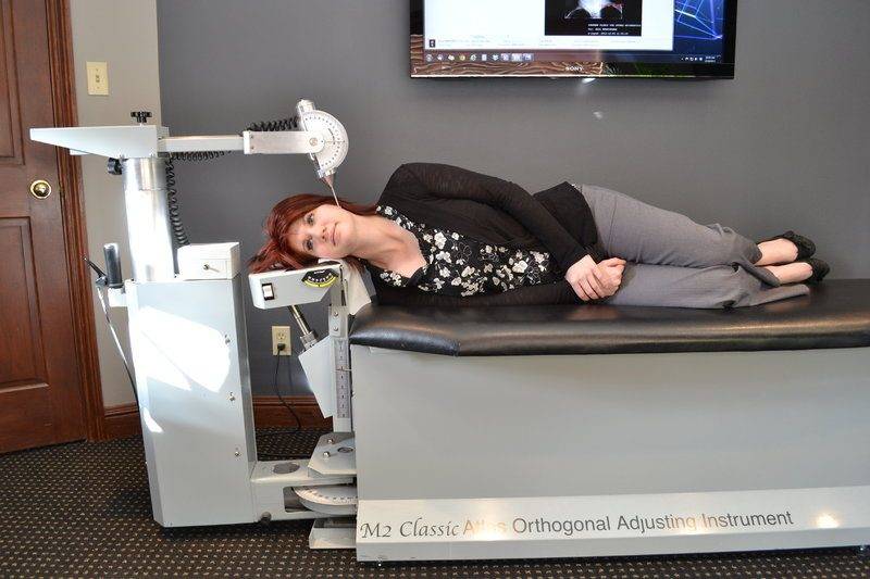

My goal is to evaluate our use of an 8 pound percussion wave force delivered at a calculated Z and Y vector through soft tissue at the level of the 1st cervical vertebra (stabilized only by soft tissue), understand why our outcomes are fantastic on some and but less effective on others, and potentially change how we do what we do just a little to improve our outcomes.
Thank you so much for directing me to the books and articles you noted. I know they will help me. I am really appreciating this wonderful platform of excellent minds that I can ask questions in.
JAA said:
My guttural response (as we do not have this well defined) is that through our instrument delivered force to the upper cervical spinal complex, we utilize a blast from a hammer hit to a solenoid coil which delivers a percussion wave through the soft tissue at an angle that has been calculated to provide the highest degree of leverage to bypass muscular hold of the first cervical vertebra in malposition by stimulating the motor nerves to alter their over-firing.
I assume you are not doing this on cadavers, since you talk about active electrical activity in the muscles around C1-C3. Is this clinical research being done under the FDA or some other authorizing body? What kind of a waiver do your patients need to sign to go through this experimental treatment? Are there any journal articles or medical textbooks that describe this procedure?

Thanks for posting that. BTW, do you have a link to the actual instrument? I was not able to find it at the GlobalAO website. Just a journal article describing their study. Thanks.
Thank you. Yes, let me know of the link does not come through correctly.
Wow, that's a big needle! Does it go all the way through her neck?
(J/K) :smile:
1/4" diameter stylus and a resounding "no" it does not go through the skin...only touches it. Ok, but, I'm still in pursuit of my original question. I'll keep plugging away and again, I really do appreciate your responses and interest. I too LOVE science.
