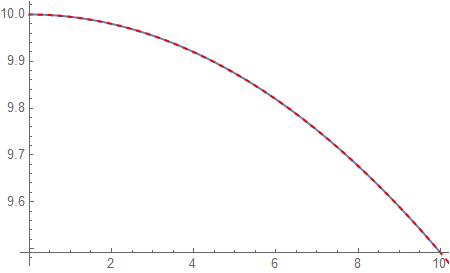

Here's how I would check it:
In Fred's solution above:
$$(y')^2=2K(1/y-1/y_0)+(y_0')^2$$
I chose the negative root and solved:
$$y'=-\sqrt{2K/y+c},\quad c=(y_0')^2-2K/y_0$$
to obtain:
x(c,K,y)=\frac{2 K \tanh ^{-1}\left(\frac{\sqrt{c+\frac{2 K}{y}}}{\sqrt{c}}\right)}{c^{3/2}}-\frac{y \sqrt{c+\frac{2K}{y}}}{c}
Next, I solved a test IVP numerically in Mathematica with y(0)=10, y'(0)=0 and K=1 and plotted the solution as the gray trace in the plot below:
[CODE title="Mathematica"]mySol = First@
NDSolve[{y[t]^2 y''[t] + 1 == 0, y[0] == 10, y'[0] == 0},
y, {t, 0, 10}]
theTrace[t_] = Evaluate[Flatten[y[t] /. mySol]];
dPlot = Plot[theTrace[t], {t, 0, 10}][/CODE]
Then I superimposed a parametric plot of {x(c,K,y),y} over this solution as the red dashed lines to confirm the analytic solution matches the numeric solution:
myf[c_, k_, y_] = Integrate[-1/Sqrt[2 k/y + c], y]
pp1 = ParametricPlot[{myf[-1/5, 1, y], y}, {y, 9, 10},
AspectRatio -> 1, PlotStyle -> {Dashed, Red}]
Show[{dPlot, pp1}][/CODE]
