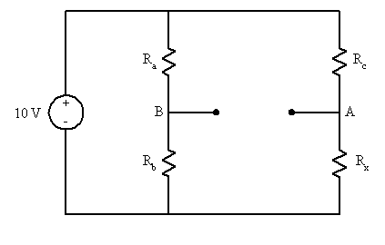

Ah I see the confusion. I'll use this image to try to explain more clearly.
Let's assume Rx is our RTD.
Rx = 100 Ω when T = 0 °C and Rx = 138.5 Ω when T = 100 °C. At 0 °C we want Vb = 0 V, therefore Rb must = 100 Ω i.e. in order for the circuit to be balanced. Using the bridge formula, Ra = Rc = 3608.1 Ω. This gives us a linear Vb output between T = 0 and T = 100 °C with Vb = 100 mV when T = 100 °C. This is the first part of the report question sheet.

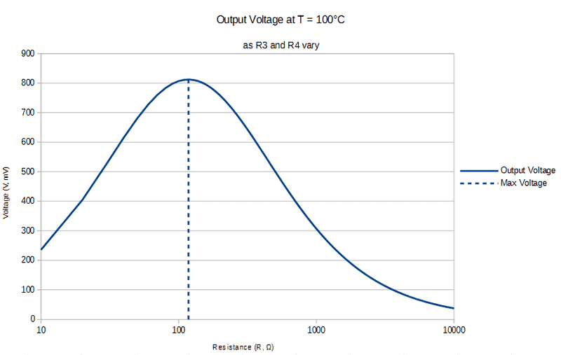

The sheet then asks us to vary the values of Ra and Rc and comment on the results. I have chosen to do this for the single case where T = 100 °C. I am therefore assuming that Rx = 138.5 Ω, and Rb = 100 Ω as per above. I noticed that as Ra,b increase above 3608.1 Ω, Vb remains approximately linear, but simply decreases. However, as Ra,b decrease, the output loses its linearity - I'm guessing that's what he wants us to notice and comment on. I decided to plot this on a graph:
From observation, I noticed that Vb peaks at ≈ 118 °C. What I would like to know, is how to calculate the value precisely.
As I say, finding the stationary points of a quadratic etc, is easy. For the bridge equation, I have no clue.
Thanks again.
Your bridge really consists of two independent voltage dividers (diagram below). Ra and Rb form one, Rc and Rx the other. It should be clear that you can scale Ra and Rb up or down in value so long as they divide the voltage appropriately to accommodate the lowest value that can appear at A:
That means when Rx is 100 Ohms the voltage at B should equal the voltage at A if you want the bridge to null when the temperature is 0C. Changing the ratio of Ra and Rb will effectively alter the the temperature at which the output of the bridge shows zero volts. The voltage range of the sensor will still be determined by the variation of voltage at A, but will have an offset determined by the voltage at B. Again, you can scale Ra and Rb without changing the bridge output. It's their ratio that "sets the zero point".
Varying Rc will change the range of the output voltage as well as the offset compared to point B. So you might end up with more or less than a 10 mV range at the output.
You might consider fixing Ra and Rb and then plotting a family of curves for the output voltage versus Rx (over the complete range of Rx) for several values of Rc. That way you can discuss how the output shifts and range scales with Rc.
